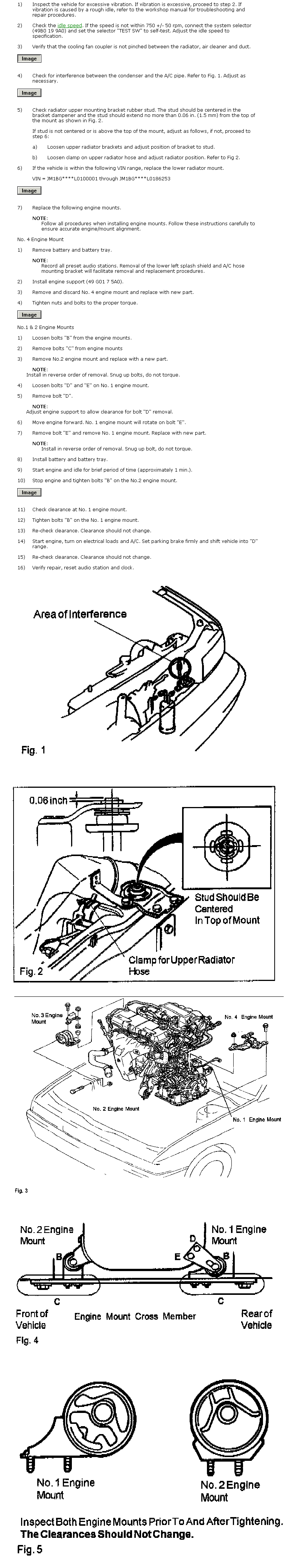

B006-95-1
B006-95-2
Jun/95
Engine Idle Vibration, D Range
  • Repair Procedure

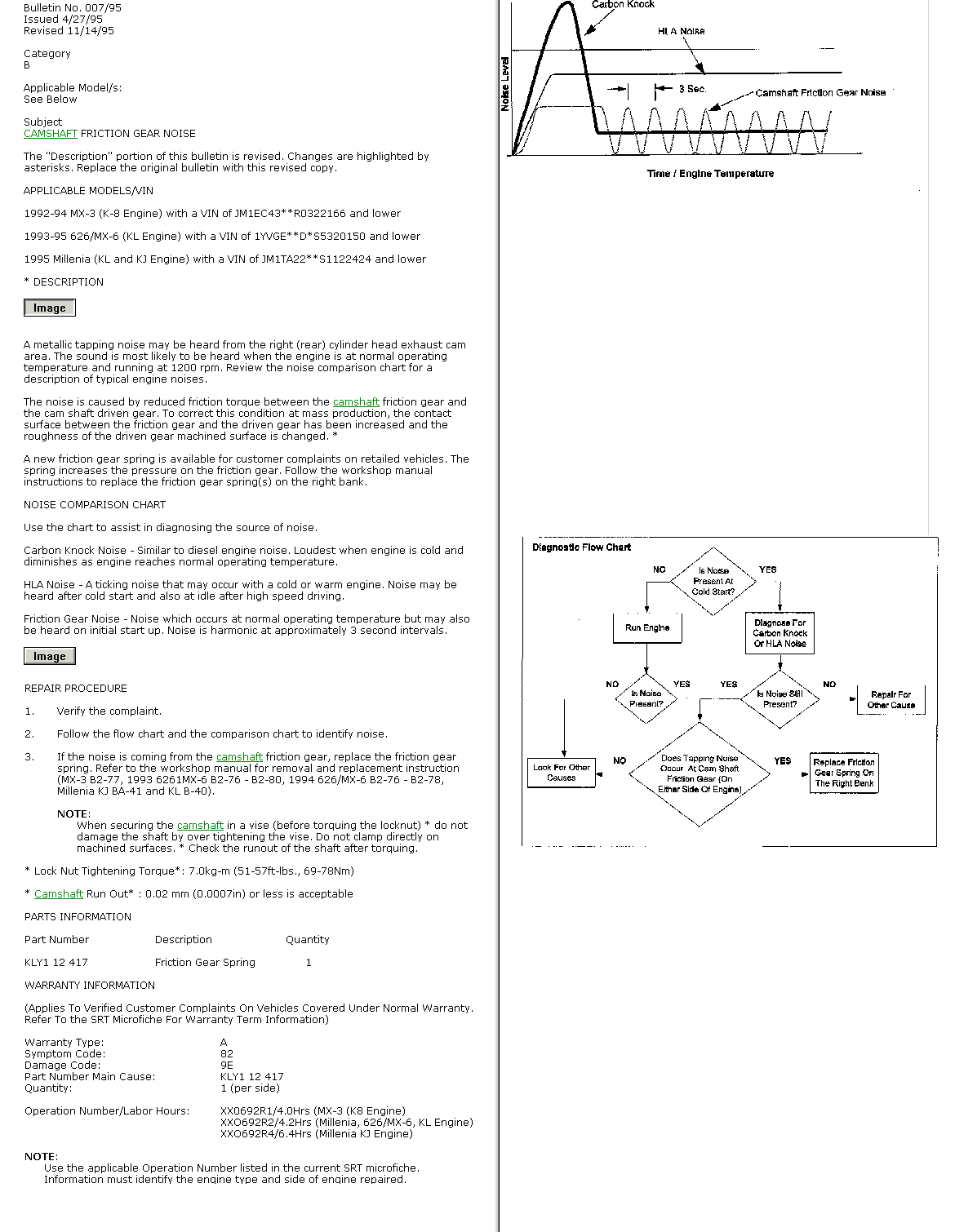

  • B007-95 Nov/95 Cam Shaft Friction Gear Noise

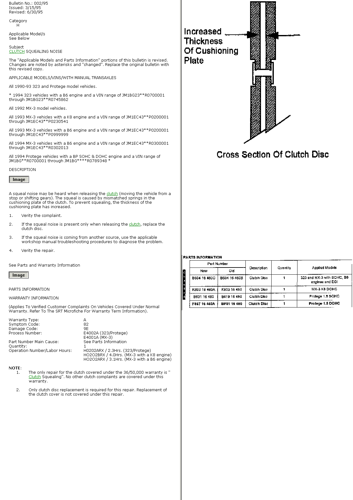

    H002-95 June/95 Clutch Squealing Noise
