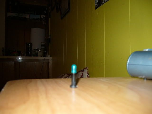

If the bar area goes out (the cold/hot area and the OFF 1 2 3 4 area) then you can fix that as there are 2 bulbs. However, you need to get a specific bulb from mazda or the wreckers.. They look like this:

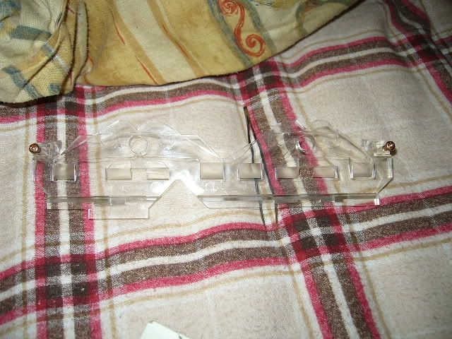

Here is the plastic peice that the light is dispursed on:

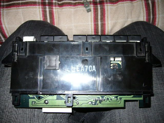

Here are the flaps to take off to get at the light and screw them out:
You must take the hvac out to do this, or at least far enough to get at the top part. Its proly a good idea to get one from the wreckers or buy mine!! PM me if you want it.
