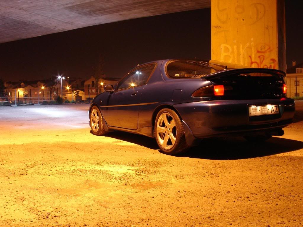

E-Spec tail lights:
E-Spec lights with Altezza housings.
One thing that has been noticed is the shape of emitted light on the stock tail light. The E-Spec lights look square. My personal theory is that they use a different housing so that the lights don't "bleed" between each other since the inner and outter lights work independantly. I'm not sure how this mod would look on stock lenses, but with Altezza's no problem.

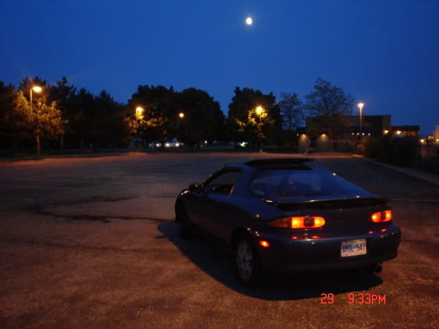

And at night:
Just the running lights:
Running lights with fog
