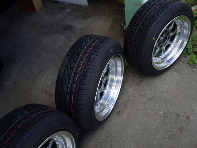

+12 with 195/45 or 50 will fit no problem, some tires stretch different to others though, like Falken's will give a slightly bigger stretch than Toyo T1Rs for instance as the Toyo has the stiffer sidewall and also rim protection. Diamonds will look pretty cool I would imagine with the right drop of course, you will have about a one finger arch gap if you go -100mm with that combo.
195/50 8J

Thanks for the pictures Sam, helps clear it up. I'm pretty good friends with a guy who works at a local "performance" shop who's done a lot of fender rolling, especially for bigger wheels with the new stance trend going and I've seen his work and he's pretty good at it so I've got faith.
The plan was to go with Falkens so thats nice to hear how that would work, I might pull the trigger next week and order a set then. Fit the wheel and lift it onto the hoist and do suspension travel measurements, I'll look out for the 10-3 you mentioned. Thanks a lot for the info, I'm looking forward to this.
