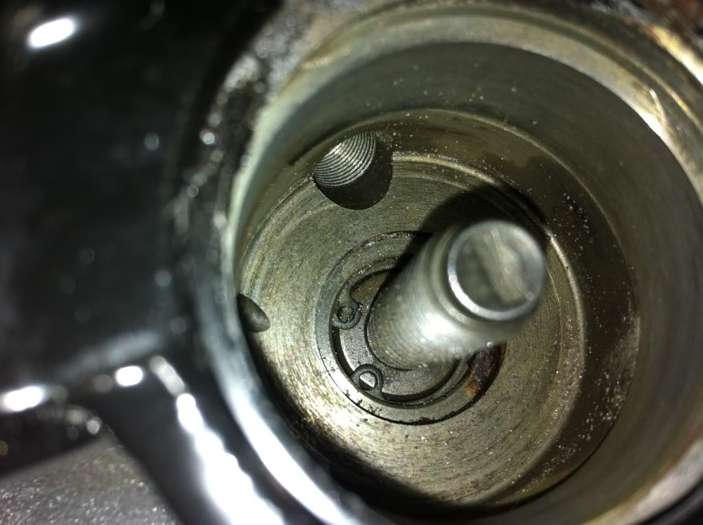

yes it should, it should also ratchet in so it cannot move back in without twisting it.
If it doesn't the threaded post in the middle is stripped, or the teeth that catch on it are stripped, and its cooked.

test again, but try to hold the piston in with your other hand. it should never fall back or feel like it slips.
