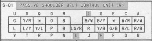

If you can not get to a dealer from the states, like me and other
non-stateside MX3ers, then I have come up with a way to disable the light
and the beeper. It involves taking the 4 bolts that hold the drivers side
seat out, removing the seat, taking the connector off of the seatbelt
control box, and using a small flat tip screwdriver to extract 3 pins, the
above 3 pins that I mentioned above that control the light and beeper. Here
is a link to a picture of the connector showing the 3 pins(highlighted in
little grey boxes) that must be removed:
Seatbelt Control Box Connector
Here is a picture of the entire seatbelt control schematic diagram:
Seatbelt Control Box Circuit Diagram
