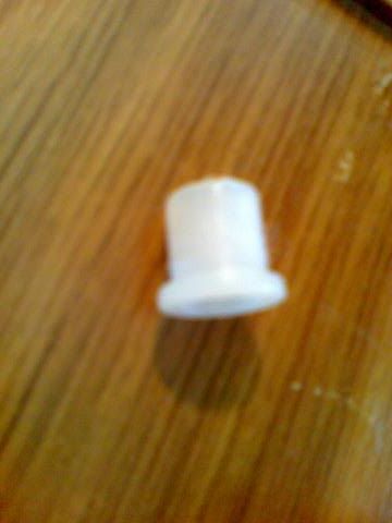

I'll measure them for you right now.
here's the one mentioned:
It's dimentions are:
10mm ID
13mm OD
17mm OD lip
2mm wide lip
I'd be happy to test these for you
10mm ID
13mm OD
17mm OD lip
2mm wide lip

Absolutely. Be as detailed and as precise as you can and I'll cut them for you. You try em and if they fit good, you can pay me later.Mad Cow wrote:Just wondering, would you be able to cut some bushings for a pacesetter shifter if I give you measurements? The outside diameter of these bushings is different from every other shifter.
How's that?

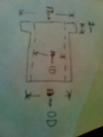

You are a frickin Rock STAR! Give me a good sketch and I'll make as many as I can from the material I bought.fowljesse wrote:I'll measure them for you right now.

Sorry. My cell camera sucks

I forgot to measure.. They're 15mm long

I've never machined this stuff before so lets just see how they turn out before I start promising a bunch of stuff. If they work well I will ask Jeff if it's ok to sell some around the forum.

I know...I just don't want to start making promises yet.
Thanks for the sketch BTW.
