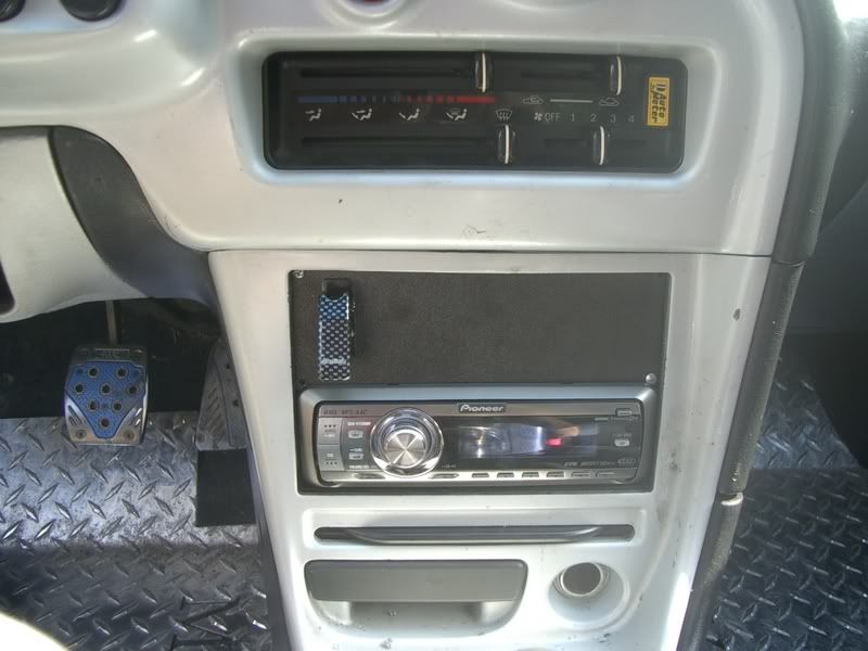

upgraded the interrior

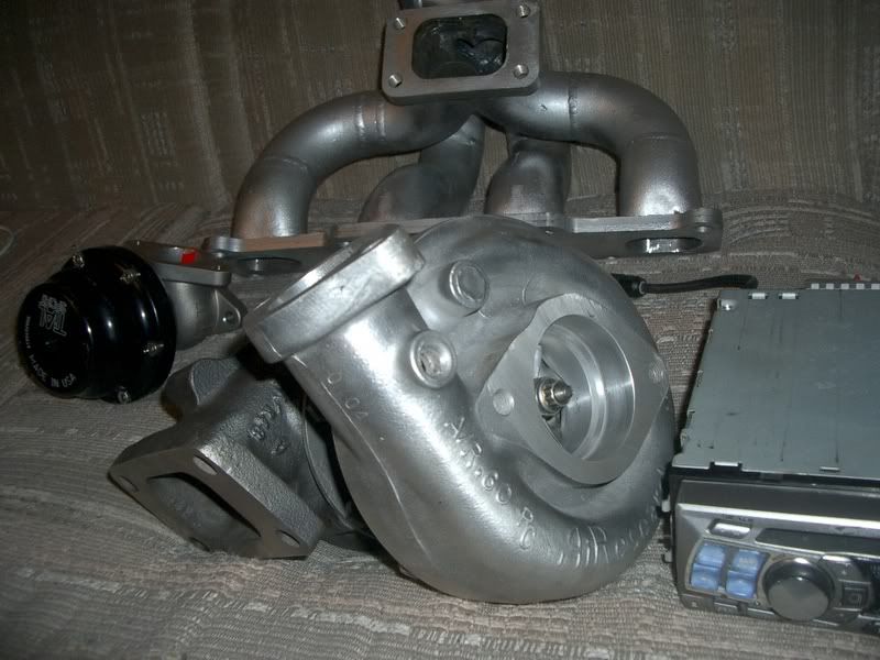

i dont remember the trim, but i GUESS it's .47 60 a/r ,
the t3 is oil cooled, i had a great deal on it , so i took it without arguing
the mani is from etdracing,and the wastegate from tial(spring rated at 1bar)
i couldn't start it, because of my innability to weld a downpipe,had to wait to spring(hard as hell).

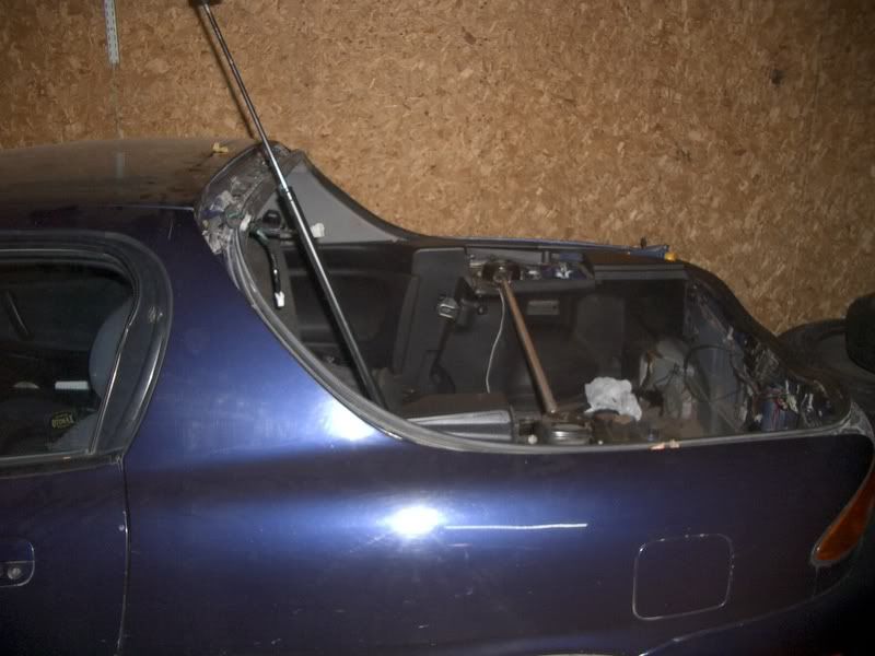

during the cold month, i had to change a couple of rusted parts, since i was sending it to the body shop anyway(rust on the roof and bad cancer around windshield)
removed the hatch, putted a shaved one

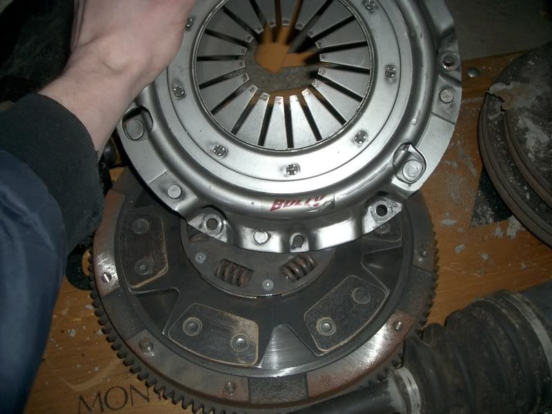

changed the clutch
for a nice sprigned bully 6 puck
changed it TWICE

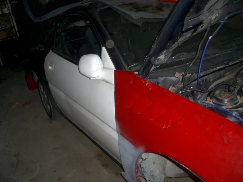

founded z3 wing , wich is heart breaking for me since i have such a love/hate relation ship with body mods. i stoped there

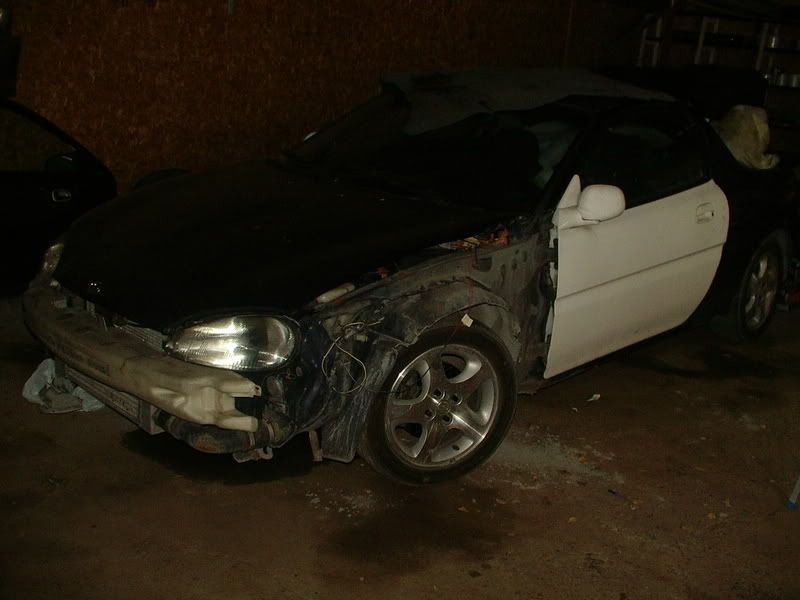

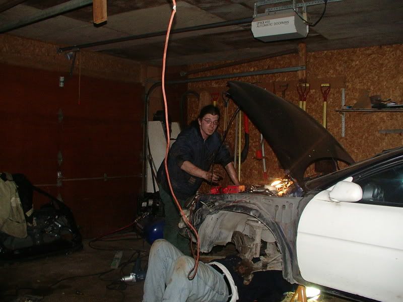

stripped the interior and worked all winter. dreaming of starting the beast week after week
assembeled things, have to go to the apointement with mr.i'll-tune-the-new-turbo-setup-wich-will-cost-me-too-much

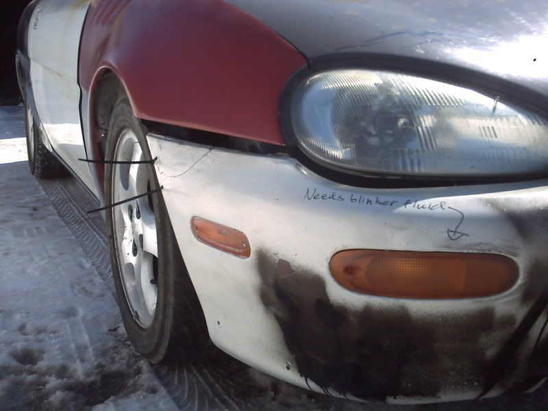

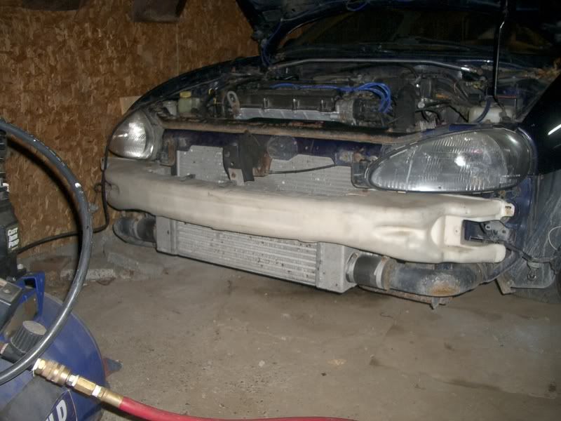

since i have to make it street legal to bring it back home after the mechanical mods, i borroed the front bumper of a friend(wich i had to mod a bit to fit the i/c )
the running gag lasted 36hours, and it was enclosed in a garage for 3 weeks.

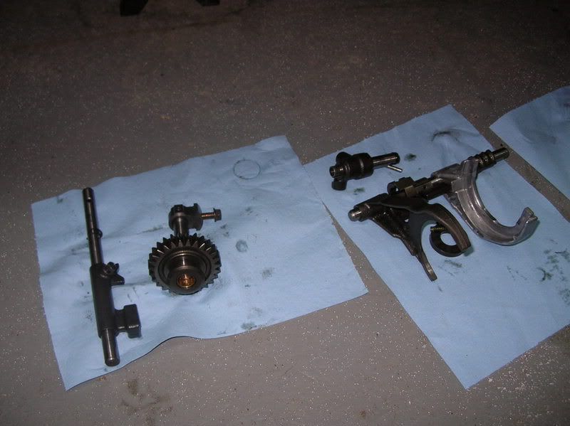

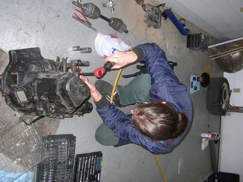

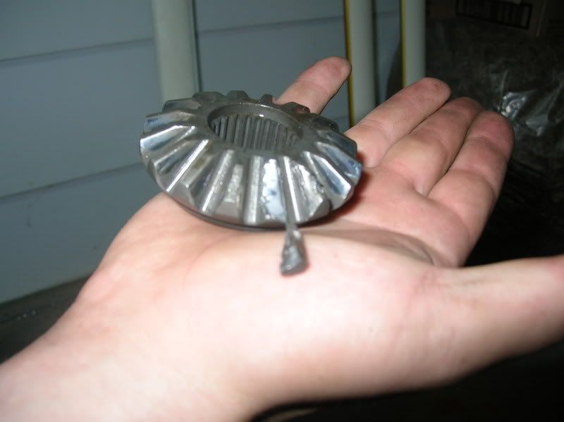

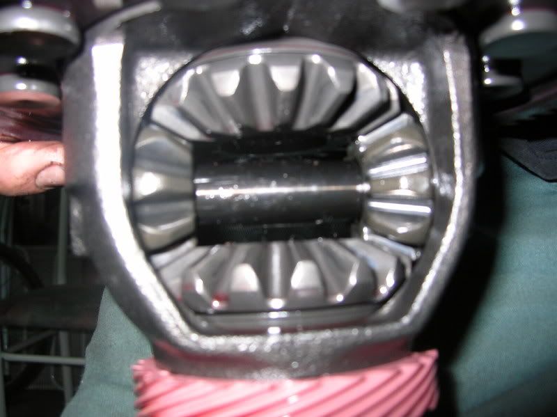

i blew a cv axelshaft and a differential last time at the strip, so i had to replace it with one spare escort gt transmition i had. wich was pretty deceving since i had a lot of problems with it(shifter'S bushing stuck like hell,broke vss etc)
since i have basically no life when my car is down, i decided to ''atempt to repair my transmition myself''
after HOURS we sucessfully got the rs-t out of the garage.
here the price of running constent 13:P
good
BAD

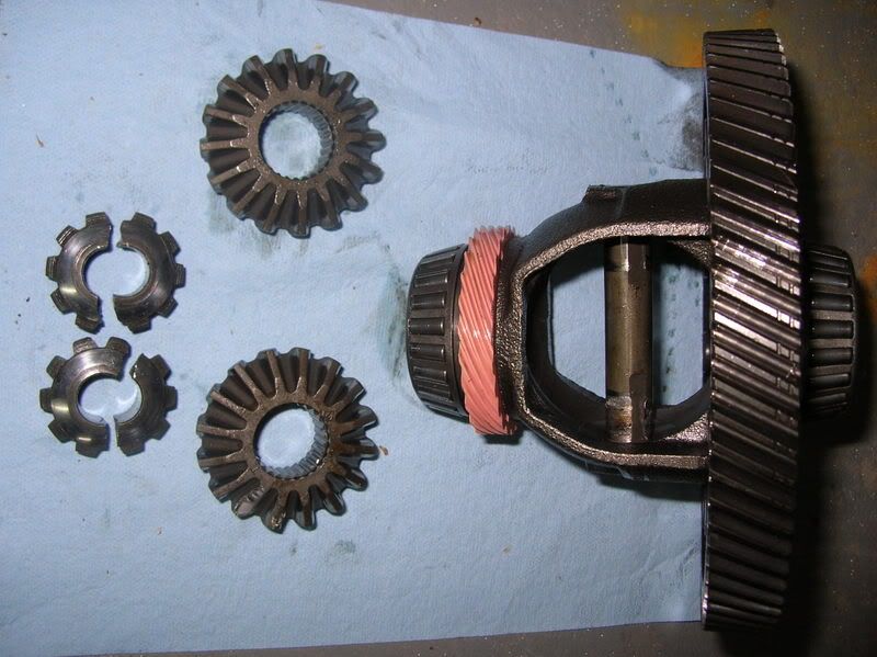

notice that one end is striiped BAD
blew one, had one spare,luckly

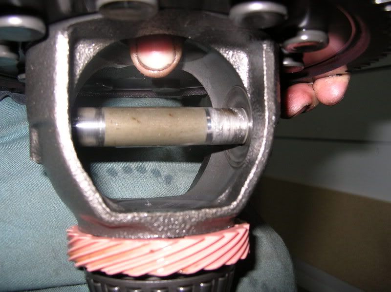

look at the damge the diff took, it's stunning, no wonder why i couldn't shift
WORST
swapped everything in, and hoped it works
if you EVER disasemble a transmition, arm ureself with a pack of those
life saver when trying to hold the 2 gear shaft in place
a lot of fun, and a real nightmare,casicaly 48 hours ago i had the fear of my life of opening a transmition
now i would repeat it tomorow
:P

here a few pic of my last trans..
Kia g-series trans
Mazda G-series trans spider gears
