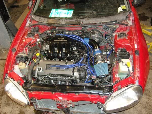

Fix that first. I wouldn't be surprised if that was the root of your problem. Your 02 sensors aren't just there for looks and for emissions, they're there to tell the ECU what the motor is doing. A old 02 sensor can cause poor milleage and misfires, I don't know what a missing 02 would do, but I would suspect it to cause alot of problems.cstott282 wrote:my front o2 sensor is not hooked up the clip was melted when i bought the car and i need to get a new one
No, you have an Mx-3, so you need Mx-3 (v6) mounts. You can use the Probe front mount with some modifications to the crossmember, I would assume that it would be the same mount with the Mx-6 ones, but the mounts, will bolt to the motor, but they're setup to me mounted in an Mx-6 chassis so they mostly won't work; the Mx-3 shares the chassis with the 323 and Protege.cstott282 wrote:aslo on a side note... with the mx6 motor mounts work in my mx3?
In other words read my post... lol?mx3autozam wrote:Are you also using the kl02 vaf from the probe. You need that with the klde ecu. Also the vris doesn;t operate correctly in an mx3 with that ecu. There is some funky wiring between the 2 cars that doesn't allow it to work properly. The best solution is to get a K8 ecu and have it chipped. Also the o2 sensor not being hooked up is an issue. I would also make sure both of them are good. Perhaps replace them. Have you also checked the ecu for codes? If there are any that can also be the lead of your problem.
