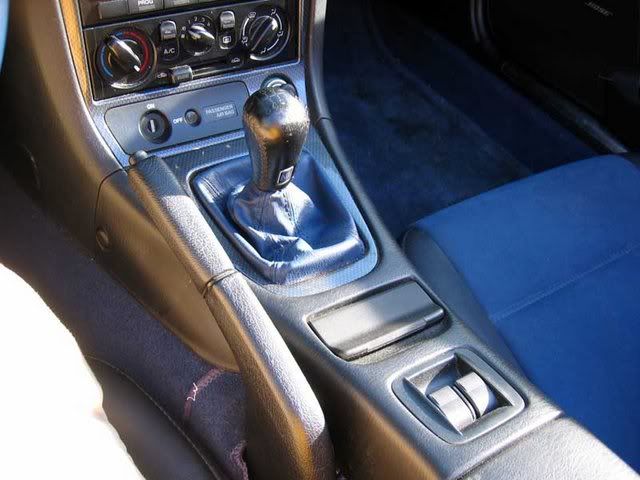

I remember someone else on here doing the same thing, except he just leaned over whenever he wanted to roll down the passender window. I eventually plan to do this mod, but I was going to take the switches out of the door and use the handle plug from the RS so that non of the door had any switches on them, and then make new switches in the style of the miata. It's a much more comfortable position imo.
mr1in6billion wrote:I remember someone else on here doing the same thing, except he just leaned over whenever he wanted to roll down the passender window. I eventually plan to do this mod, but I was going to take the switches out of the door and use the handle plug from the RS so that non of the door had any switches on them, and then make new switches in the style of the miata. It's a much more comfortable position imo.
Lol, i have to lean over as well, but that's only because the passenger control switch on the main control box went and i didn't care to replace it until i figured out what i wanted to do.
What are the switches in the miata like?

Right behind the shifter. It's incredibly comfortable since you can keep your left hand on the wheel and your right hand barely has to move off the shifter.
