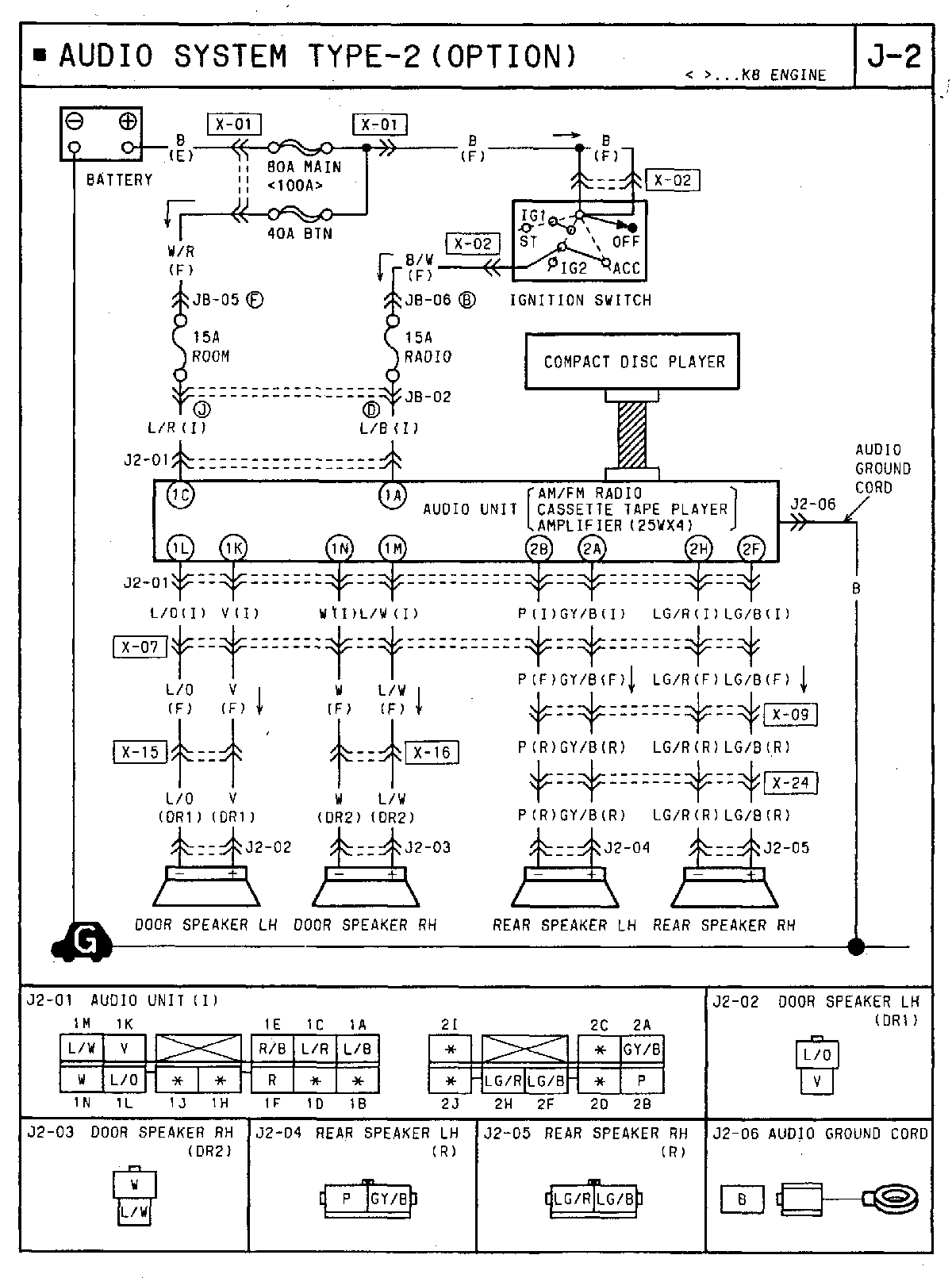

Ok, which color is which in this car. I am replacing speakers and want to solder, wire, myself. How do I know!! lol

One of our junior members (KR) posted this a little while ago... I think it should answer your question:
door lh:
+ Violet
- Blue/Orange
door rh:
+ Blue/White
- White
rear lh:
+ Gray/Black
- Pink
rear rh:
+ Light Green/Black
- Light Green/Red
door lh:
+ Violet
- Blue/Orange
door rh:
+ Blue/White
- White
rear lh:
+ Gray/Black
- Pink
rear rh:
+ Light Green/Black
- Light Green/Red

Picture from the main mx-3.com site... http://www.mx-3.com/tech/audsys/aud_sys_diag.gif
