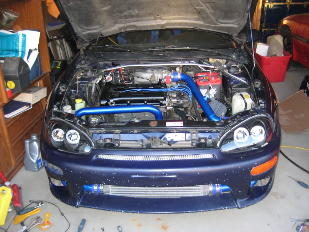

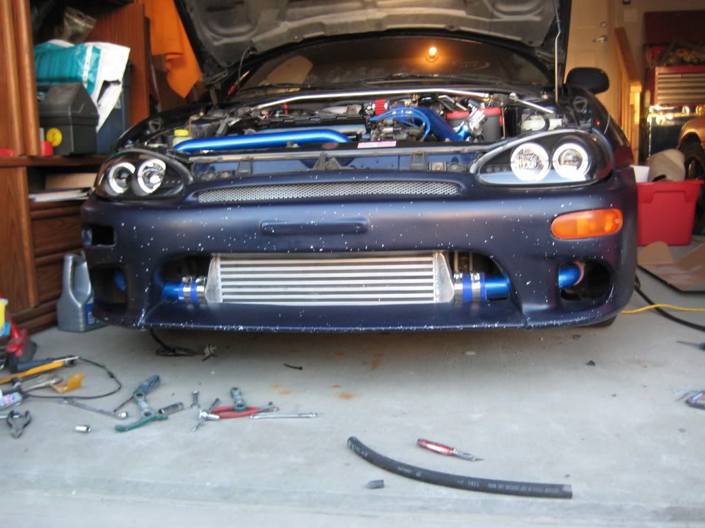

New red top battery in, and bumper fit once again. As a note.. make sure your clamps are on your pipes and tight before fitting the first time. It'll save you from doing it twice. All that is left are the coolant lines.

She's ALIVE! She starts and idles. Still need to get some nice 94 octane in her and fill a few maps for tuning.. other than that, it's finally down hill. :froggie_red:

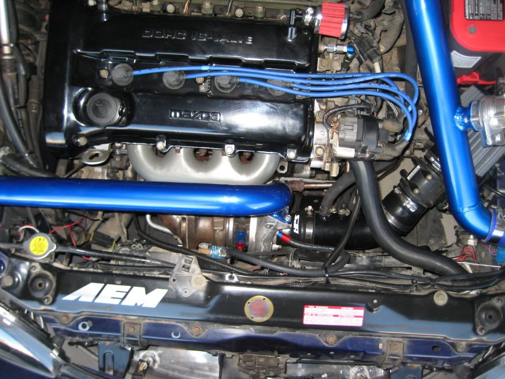

After 6 months, the car finally drove. I still have to clamp the MAF voltage... the ecu has no idea what to do with boost just yet. I did spool up to about 4lbs though... she is far from fast right now but I'm excited.. That damn turbo spools soo damn quick. I did notice that my under hood temps are much higher and will need a turbo wrap and a mani heat shield. Not sure if fans are kicking in yet either. Plenty of time to work out the little stuff. :driver:

Starting the tuning process. Running quite rich right now. About an afr of 10 most of the time. Hitting 4psi and a little above with ease. She is starting to feel quick. My under hood temps are still quite high. Will have to cover that beaut of a mani with a heat shield :(

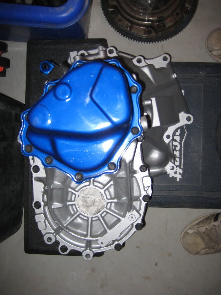

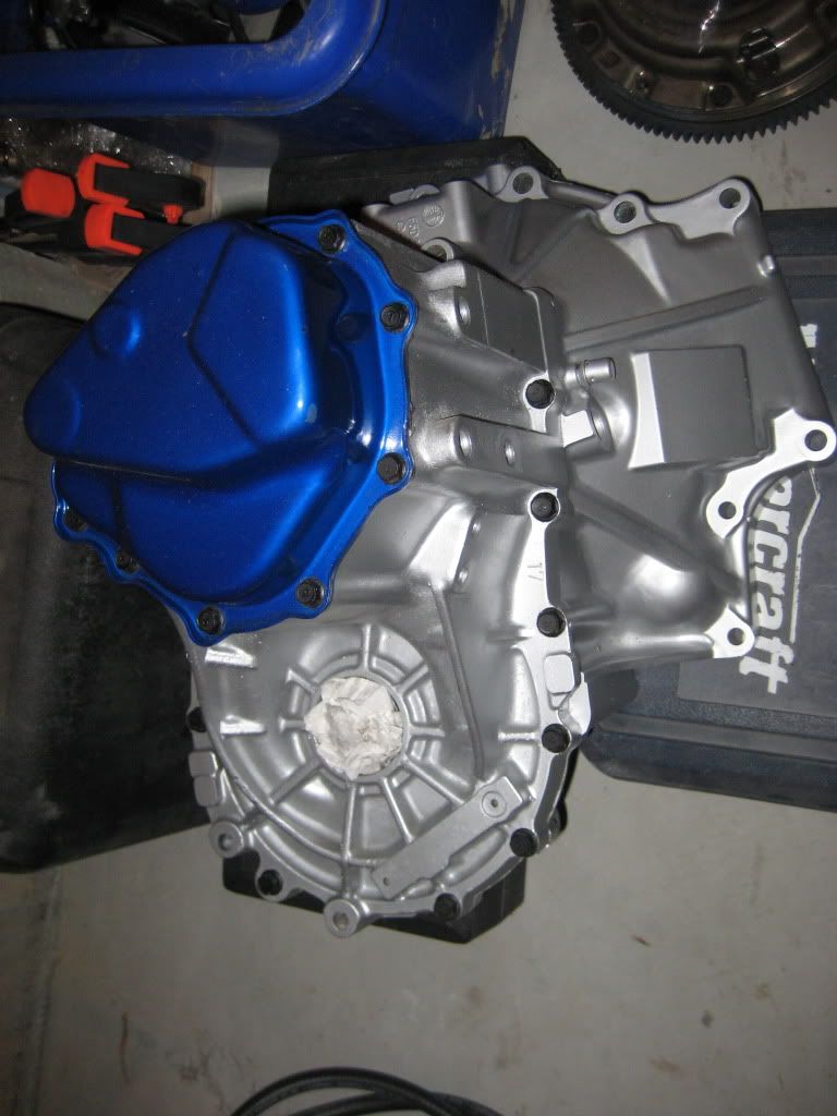

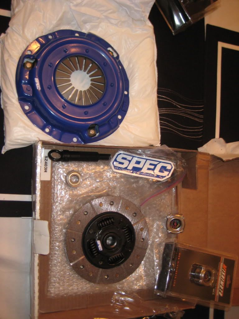

It's been a while since I've posted anything in the log. First off, I recieved an ever so slightly used F series tranny from MI|<E. Not only did the guy clean the tranny, he painted it to match my engine bay. <- What a guy! :2thumbsup: He also supplied an extra fly wheel and some mounts. Thanx again man.

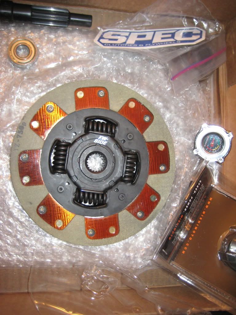

My clutch kit came in from Image In Motion.
Spec stage 2+ good for 275 lb-ft.

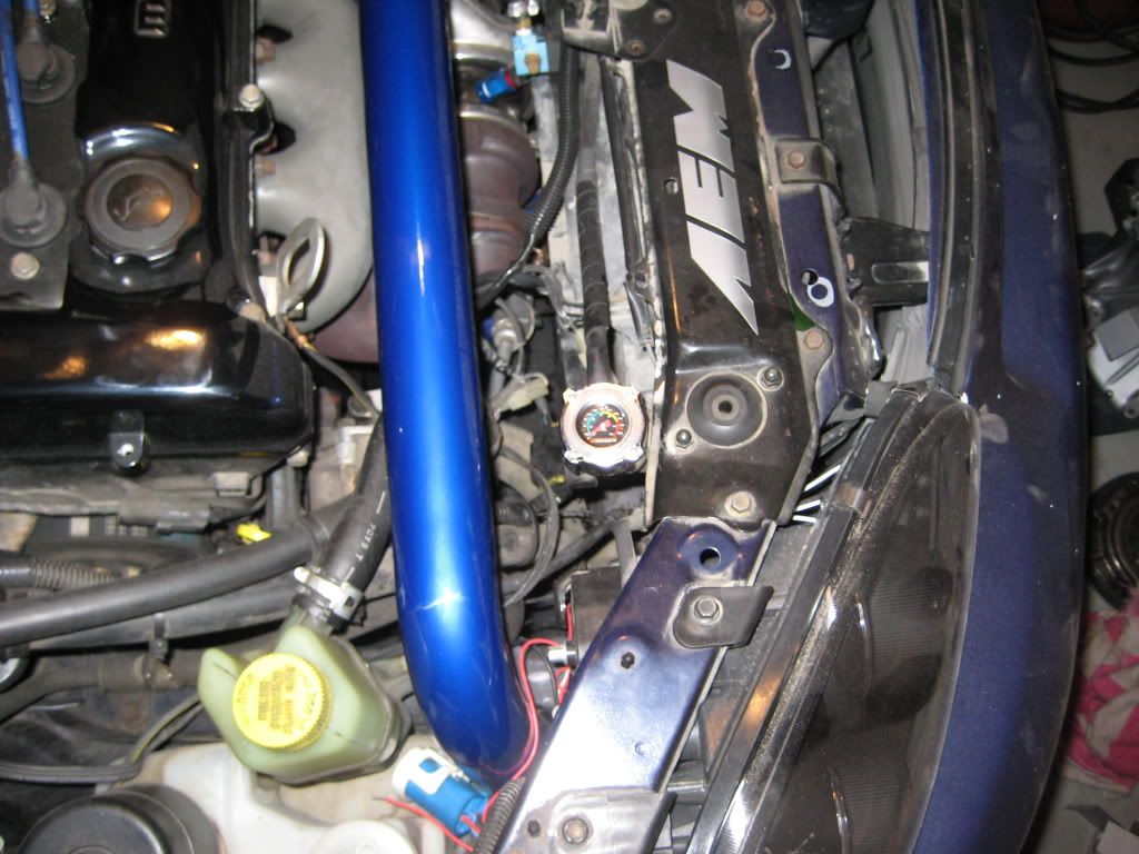

Also included in my order was the Mishimoto gauge type rad caps (~19psi) x2. 1 for me and 1 for Mike.
Sorry for the crappy pic of the rad cap. It's F'n cold here right now.

wow that tranny looks mint!

This car is awesome. Never seen such love go to a tranny.

nice tranny is hot

That it is. But I can take no credit. That is how I got it. MI|<E did all the work. Thanx Again!!!
