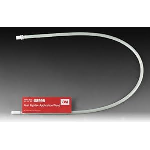

Don't use rustoleum. If you want something that will work, use POR15. You will need spray wand and undercoating gun. You can reduce POR15 a bit as it's pretty thick and is usually brushed on.
You insert it inside one of the frame rail holes and mask off others so it won't shoot out. It has 360 degree head so it will coat inside of entire frame rail.

I've attached pictures for reference. I bought same exact tools. I think I've paid less than $50 for all of that and I know I can use it over and over. It does not require much skill. All you do is fill it with por15 or other rust treatment, screw spray wand on the end of it and spray inside of frame rails/areas you can't reach. As you're moving it back and forth it will cover entire inside of frame rails with rust treatment.Ryan wrote:You lost 90% of us at the "you need a wand and a spray gun" part.
