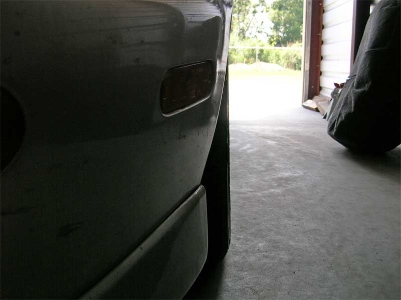

I run 225/50/15s on my tokico/dropzone setup. It's about as large as you can fit before you have to use spacers and/or very low offset rims. Here's some pics. I forget the offset of my rims, either 40, 38, or 35. I got them in a 6.5" wide rim to accommodate for the offset and move the physical centerline out to avoid rubbing the struts. They're microscopically close, but they don't rub.
