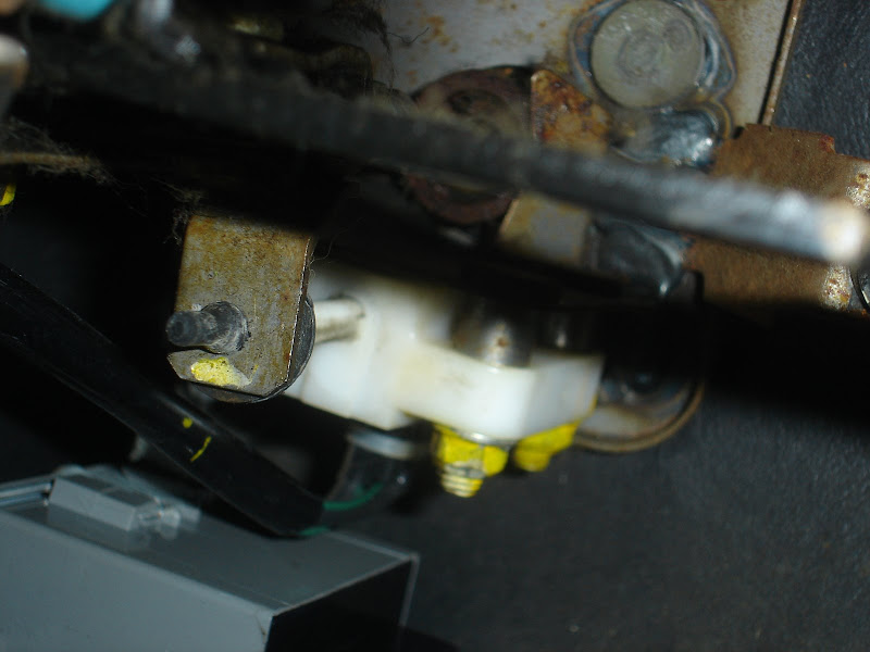

OK Here are some more pictures. If anyone could help with this, that'd help me eliminate more problems. These are all taken w/ clutch pedal in the rest position.
First Picture. The electrical tape was wrapped around the metal and plastic piece w/ the yellow smudge on it. It was about 1/4" thick.

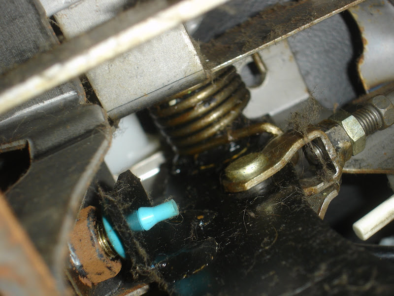

Second picture. See that white rod? Thats what the tape was pushing against when the clutch pedal was pushed in. Its the same rod as in the 1st picture, just at a different angle.
Also with that second picture, (because I don't quite understand from the manual) what the clutch supposed to feel like/look like with the proper settings? I understand the height (which is a separate screw from ones shown) but how to I set the engadgement?

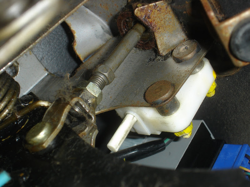

This third picture shows the blue rubber piece by the height adjustment screw. Does anything look out of whack in these? What should I be looking for?
