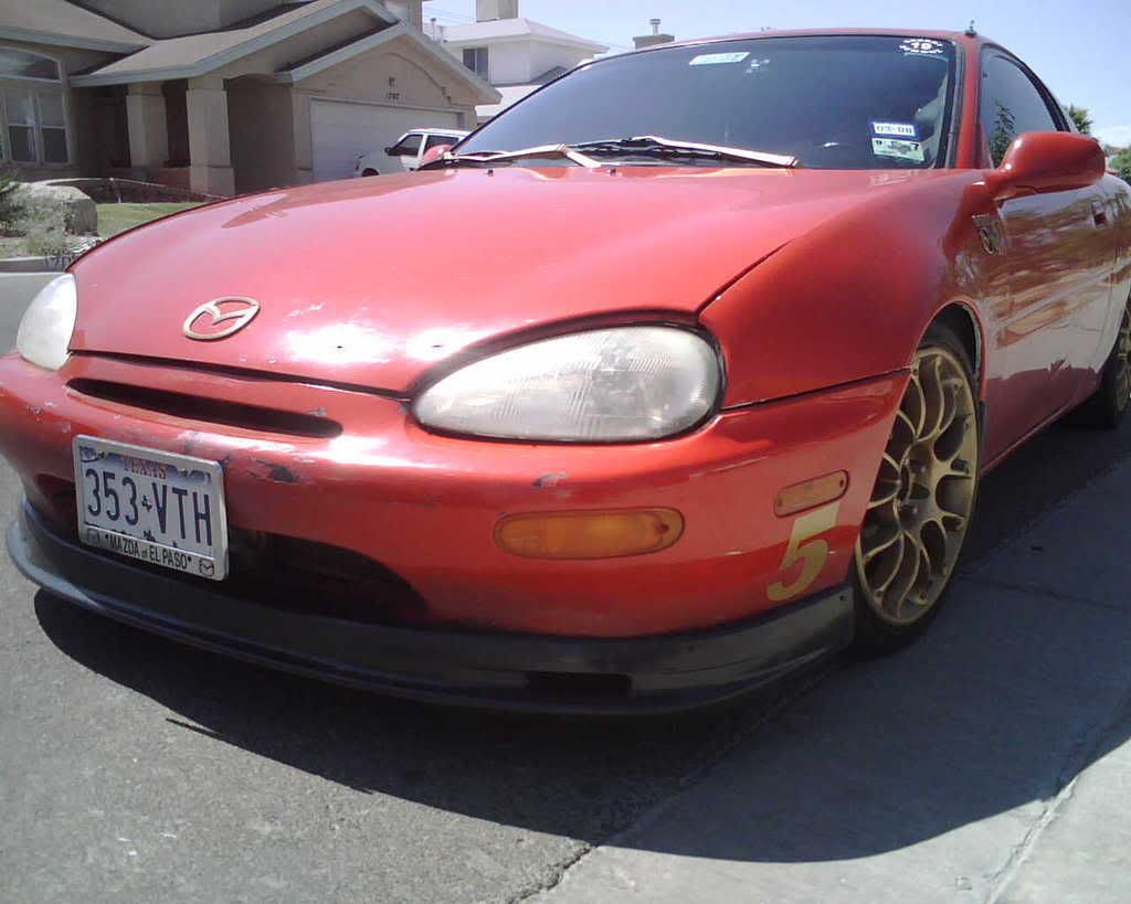

guys sorry it took me forever to post some good pix but here we go... i just put this one on last week it is off the integra 94-97... YES THERE IS LOTS TO MODIFY! BUT IT LOOKS GOOD!.... i was the first to do this about 2 years ago and now i have perfected it!
for your veiwing pleasure and by popular demand i show you my MUGEN CUSTOM JDM MX-3 LIP!
just in case you wanted to know about this next pic... these are my racing tires... i traded my mx-3 rims to my brother for his escort gt rims... i just did the fan black with a clear coat and polished the lip on it....
COMMENTS ARE ALL WELCOME! NO I DONT SELL THEM IM SORRY BUT I CAN GIVE YOU ASSISTANCE IN CUTTING YOURS OUT!

well this is what it looked like when it was red

the red one appears to be slightly different and more streamlined. the black one looks blocky.
nice job though.

Correct the red lip was off a civic coupe but I like this one more I m o it makes it look wider

not a fan of any of the emblems.. like it better red....

Hey guys thanks for all the comments I like having it black because it just stands out a lot more. As far as the gold goes. Guys honestly I don't even know what happened it started with decals then rims then emblems then interior in the end I loved it so I just kept it.

I want more details on the red one, please.
got any pics of what you had to modify to get THAT one to work?

whats up rudy, nice work on perfecting that lip! looks great. but if i had to choose one............THAT RED ONE LOOKS ALOT CLEANER, and SLEEKER!! but still mad props.

The red one is off of a 98 civic coupe ek. I got a dremel rotory cutting tool and cut the mouth of the lip because the mouth on the lip is bigger so its measure time. Once that gets done you gotta cut of the ends and drill your own holes on the lip all the way in to the bumper and make sure its bolted nice and strong. The holes on the lip need to be perfectly aligned to the inner portion of the front corner lights or else it will look wierd. Make sure you push the corner ends down to give it an aggresive look or else it will look like its smiling. And it looks really panzy like that.
Another thing to consider is that the ek lip which is the red one is more easily broken due to the fact that the bends to fit our bumper are a lot rougher than those designed. Consider that before you invest in these lips.
