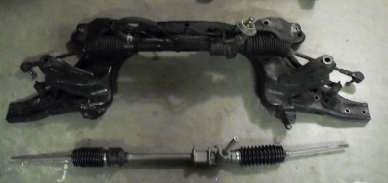

Subframe out with manual rack sitting in front.

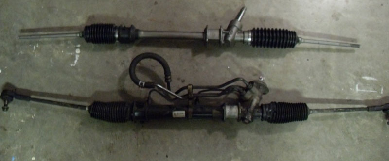

Two racks next to each other.

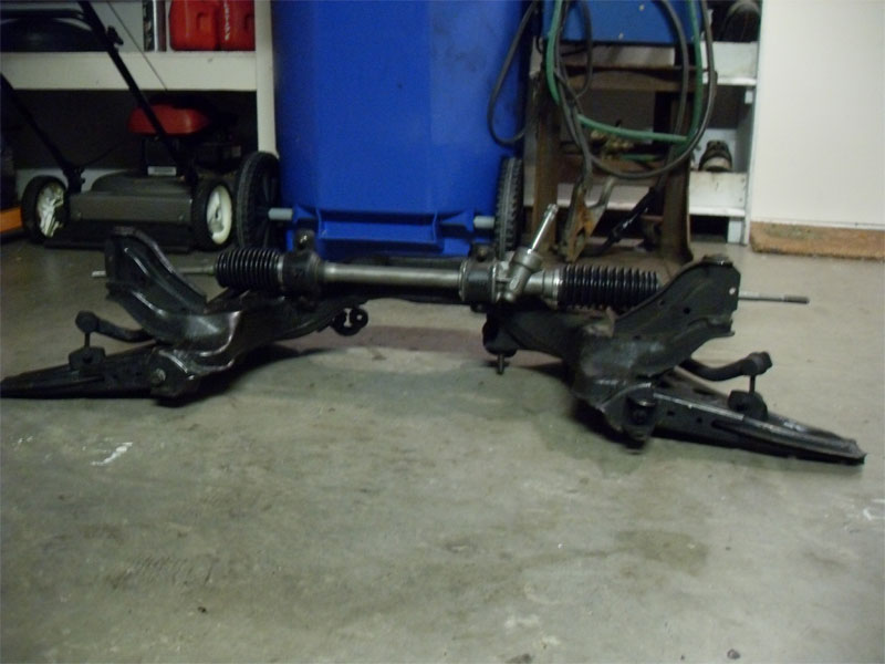

New rack installed on the subframe.
