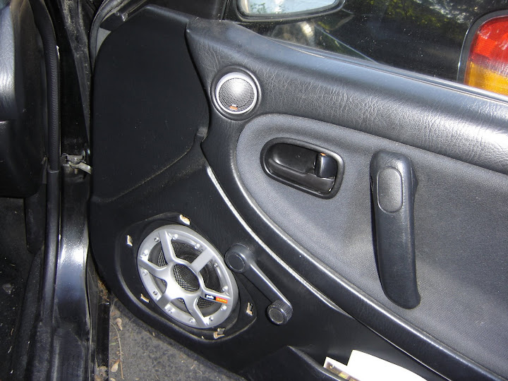

My unfinished doorpanel/speaker install. Switching to different car, so hopefully I will finish it there!
