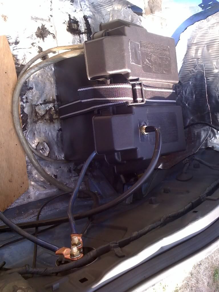

I moved my battery to the right rear, and put it in a $15 battery box that I screwed down. It wasn't vented, so I went to my favorite auto parts store, Home Depot, and got a brass fitting that has threads on one side, and grooves on the other, and some cheap tubing. I drilled a hole in the box just barely smaller than the fitting, so I could thread the hole, and screw it in. The vent tube goes down to the rubber bung at the bottom of the spare wheel well. I have no spare, and keep a can of "Fix-A-Flat", and a "AAA Gold Plus" membership.
When you move the battery, the NHRA requires you to put in an external Kill Switch, so I got one for $30 (Taylor), and drilled a hole for it. The width between the inner bulkhead, and the outer plastic piece was too wide, so I used a hole punch to pound out a circle, starting about 1/4 inch between indentations, and going in between them, each time around, making new dents, until the whole thing was recessed enough to put in the switch. It was still about 1mm too short, so I trimmed it off the back of the switch itself, with a pneumatic cutting wheel, using Vise-Grips to hold it.
I don't know what the battery cable costs, because it came with the car, but this project costed about $60, using a friend's tools.

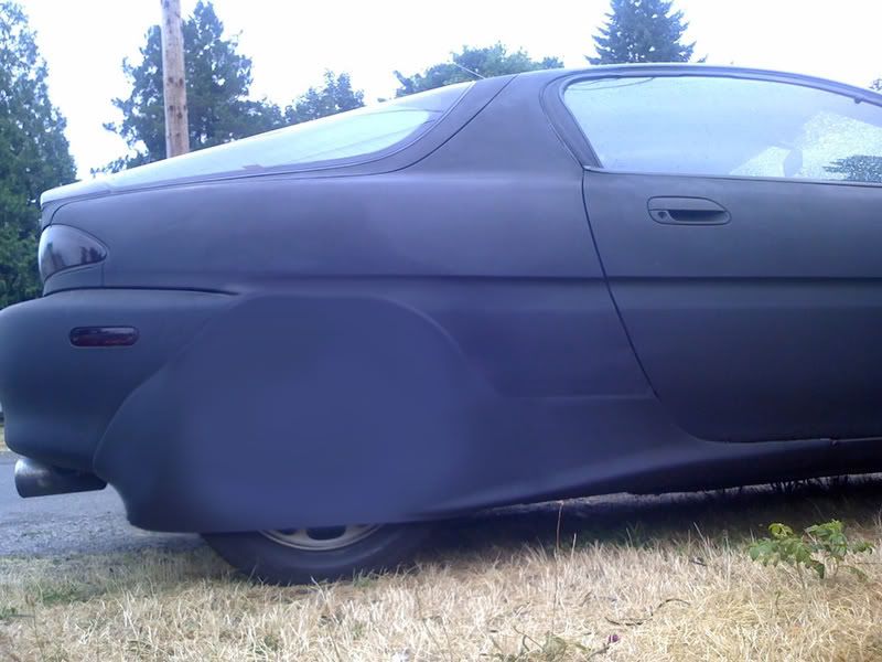

i did this and it looks nice coming right out of the plastic. if you cut it nice enough it almost looks stock. the rear seat hides it nice too. and maybe you should take a long hard thought before you start making your mx3 look like a cadillac by covering the rear wheels like that photoshop mock up, up there^^^mx3autozam wrote:Its a really nice car. the H&R does a pretty decent drop as well..
You do know that for the rear strut bar you can still leave the panels in. Just cuta small notch in them for the bar to come out of.

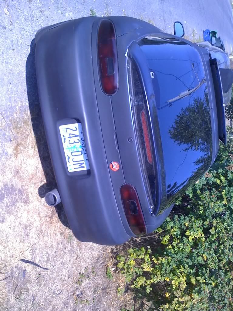

The wheelskirts are on. I started moulding in the MazdaSpeed sideskirts, and will do the bumper, and whatnot.
I'm leaving the area behind the seats completely open, with carpet covering the walls, so I can haul my bed of nails, and other important things
It will look like it came that way.
