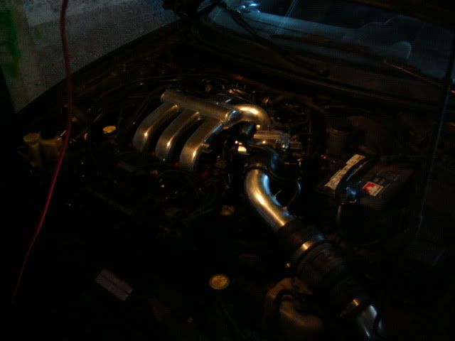

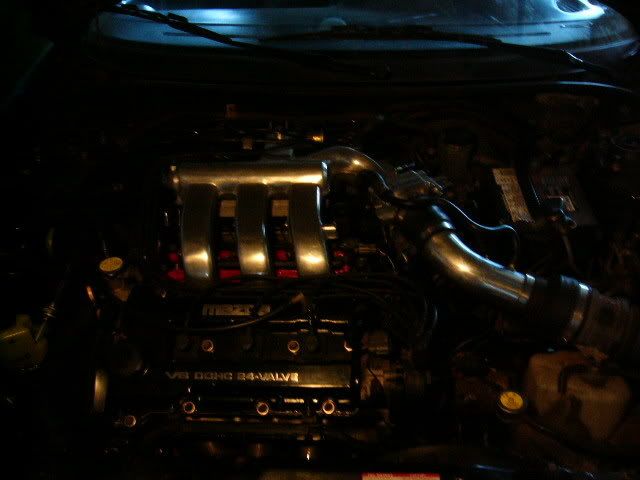

Couple more shots of the motor in the car.
Dont make fun of the cheap battery

Cheap batteries are OK in my book as long as it works. The ZE sounds great and in the dark pics it looks sick (in a good way
) Nice work on it altogether. Its nicely done.

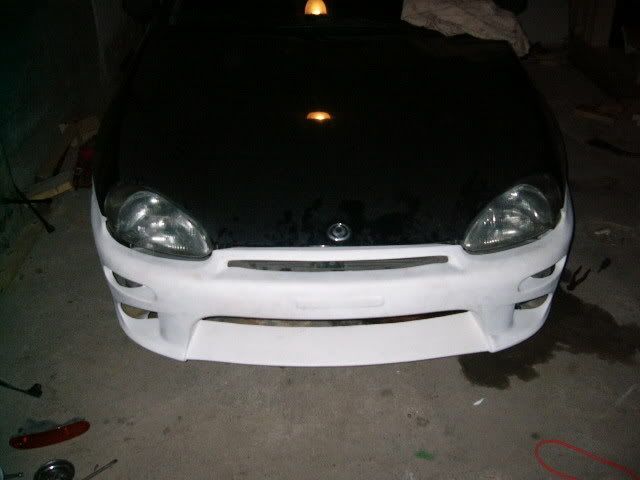

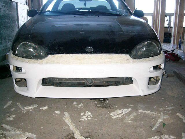

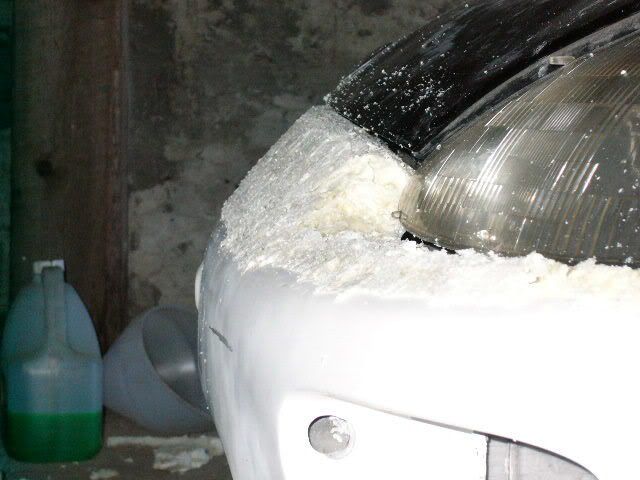

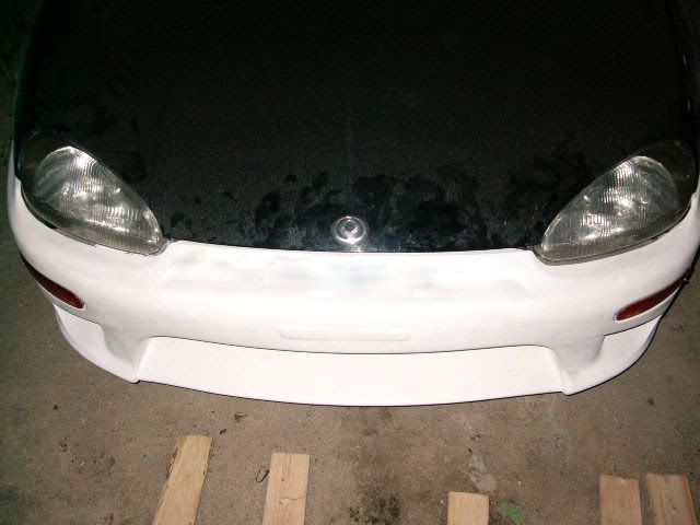

I decided to *customize*
my front bumper. I did not like the way it was sitting. So I decided to try something. If I dont like it ... It can always get mounted on the wall!

It's not Fiberglass, It's not Bondo .... What is that???

it looks like you used snow

its spray foam. I'm using it as a base befor I f/g... then I will use a little body putty to smooth it out.. then prime and paint.
