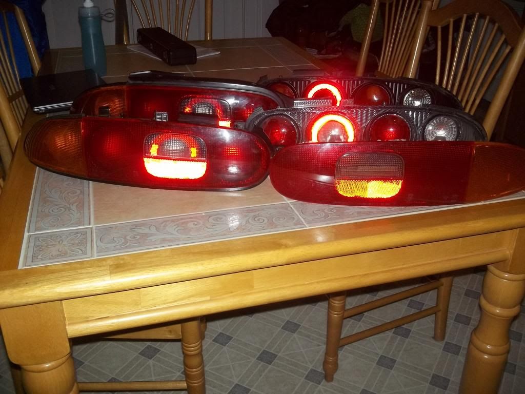

I have been trying to get some little things done for when good weather hits.
These are the custom taillights I'm working on.

I like what you did with the tails :mrgreen: you should paint the altezza solid black and it will emphasize the rings more. 8)

The lights are actually a pain to get right. The reverse lens on the altezza actually hits the factory outer lens. To fix this, I heated up a round screwdriver end with a torch in order to melt and shape the inner lens where it hits.

Looks good, I am actually doing the same thing :) I ended up taking the round reflectors off, then trimmed the OE back up housing to fit the altezza.
I like the carbon look in there.

I was nervous about trimming the oe inner lenses because I didn't want to make a spot where moisture could get in. :shrug:

not the lens just the grey plastic diffusor behind the lense for the reverse light. I was just trying to make the reverse light function through the OE reverse location. I can send you pictures of what I am talking about when I get home.
