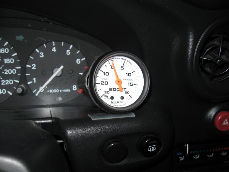

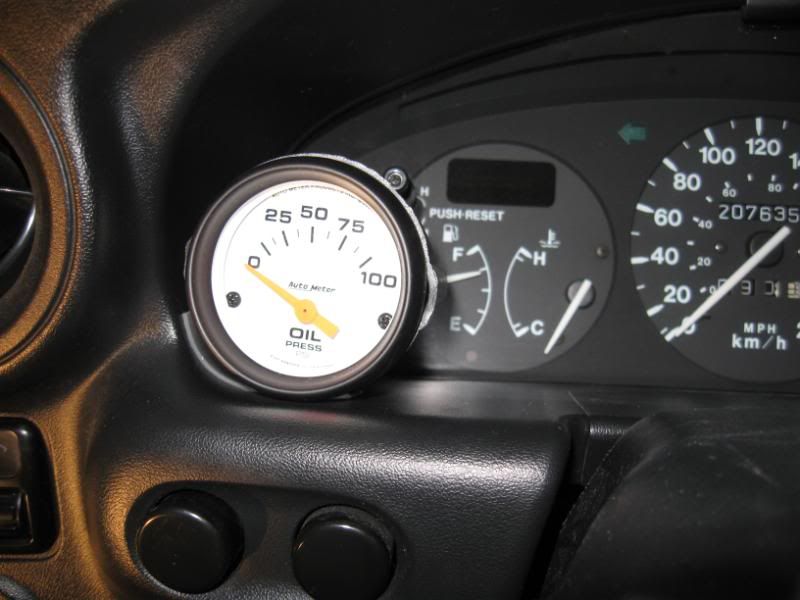

Tentative permanent places for the gauges:

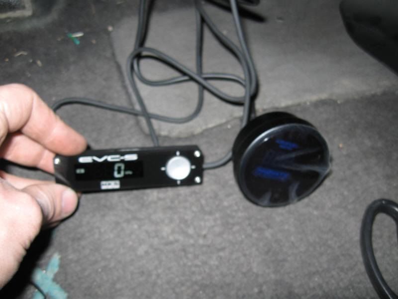

Wideband and Boost Controller wired in:

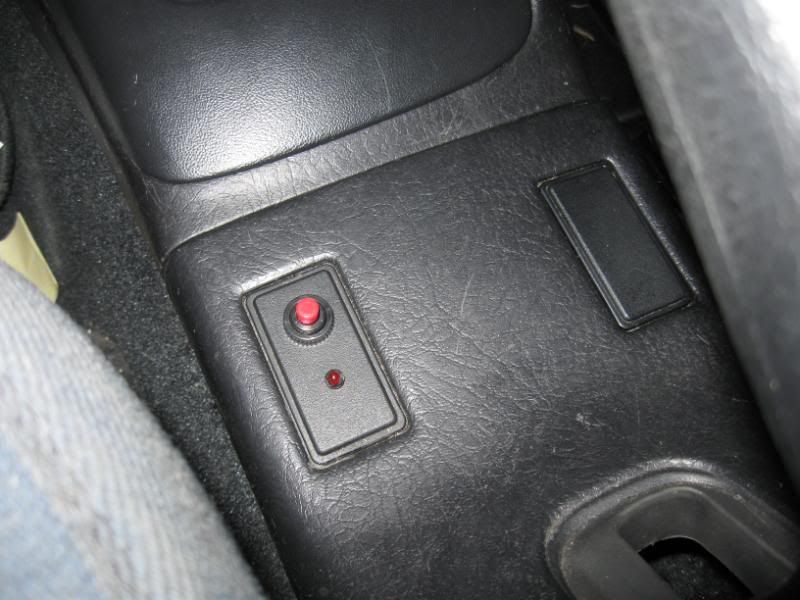

I put my wideband calibration button here:

This is great work... have you thought about putting the gauges in the 2 middle vents?

There are ideas... Something no one has done before.

I think I may mold the autometer black gauge cups
into the sides of the vinyl where they are.
keeps all the info at one glance
Re: Mi|<e - 94 RS BPT
yeah I think it would be cool if someone would make a cluster with a spot for 2 gauges like that for 1 on each side for the 92-93 dash... I remember seeing a DSM with that product... I like it!

Why do you need to calibrate the Wideband more than once?
Mi|<E
Posts: 709
Joined: March 30th, 2006, 8:55 pm
Post by Mi|<E »
Multiple reasons, mostly for accuracy. Change in altitude is the largest concern at 3438 ft above sea level
