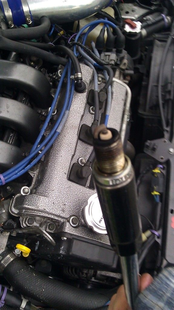

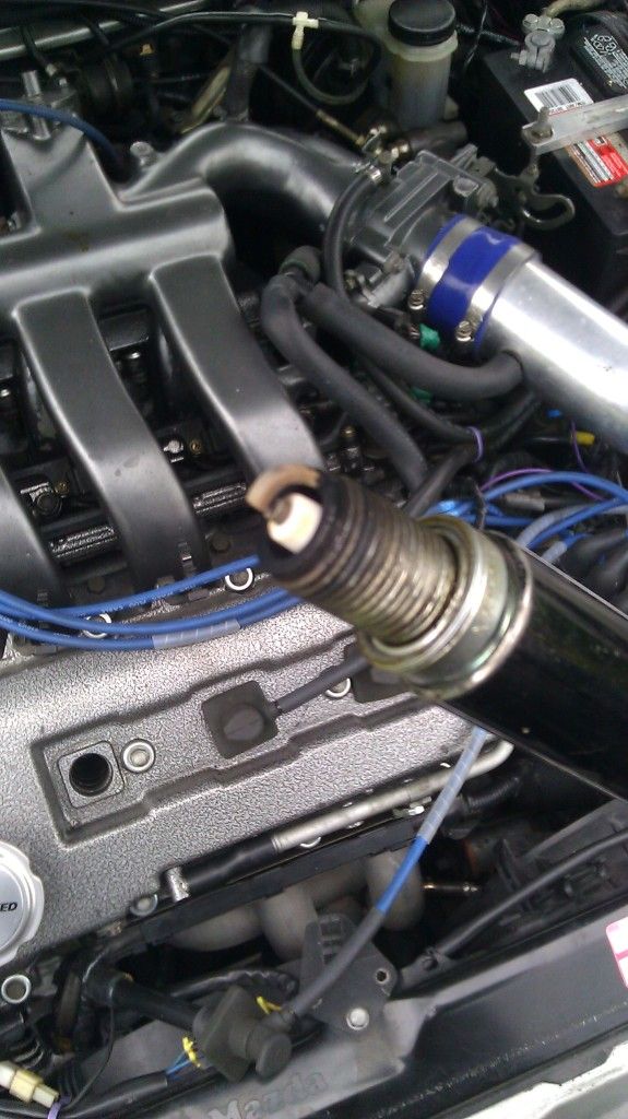

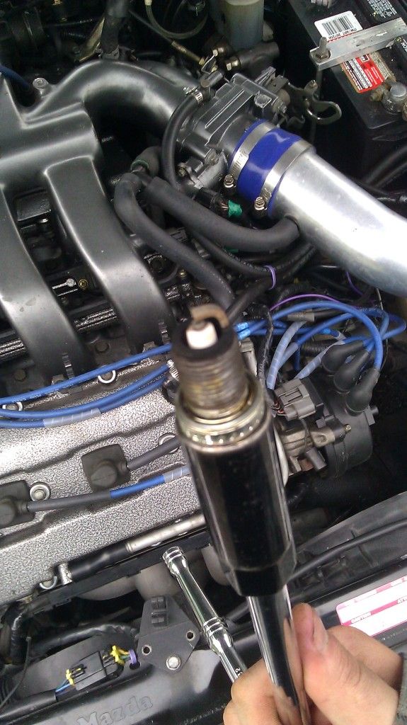

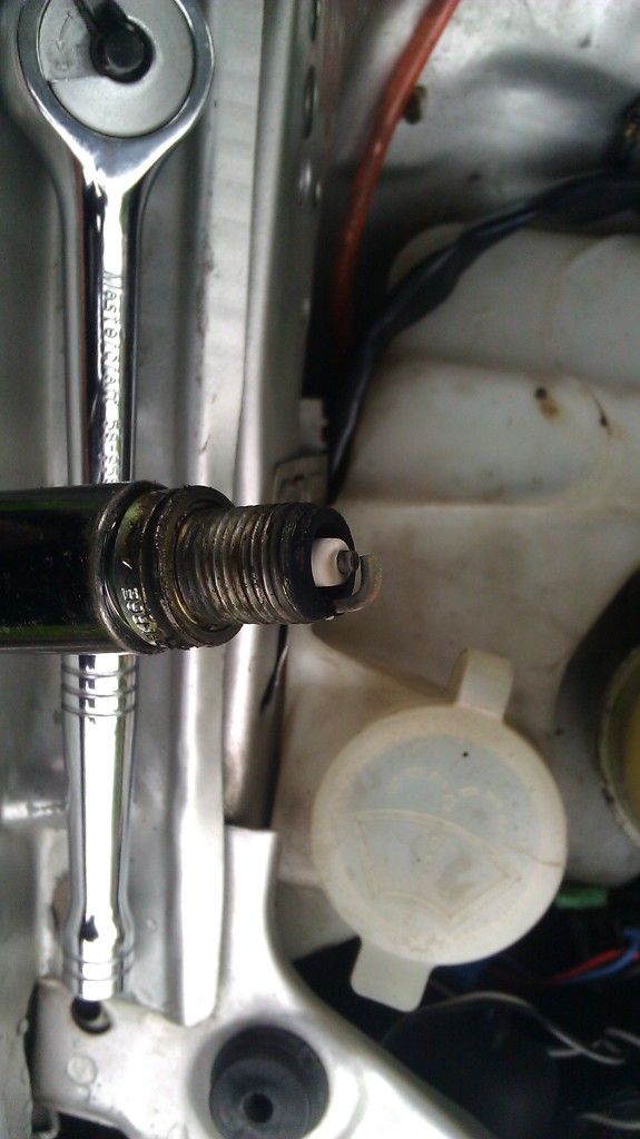

heres some pics of the plugs i just took after driving home from school. i have a bad sense of smell so i didnt smell much but there was a slight burnt odor that i could make out.they felt dry, the ground strap was greyish white, and the bottom of the threaded part was black and had a bit of loose carbon it looked like. do these hint to anything for anyone?

Those plugs look perfect (how many kms on them?) , if they're all like that, I'm going to say that there's nothing wrong doing on in the motor or the mixture, and it's NOT running rich. Similar to this, this is rich:
I'd be curious to what a vacuum gauge says under regular cruising (unfortuntaely I never had one onmy Mx-3 for me to compare) but wondering if she's working hard for some reason.

thats my cell phone so i dont have macro on it... the plugs are maybe 7 months old? my vacuum gauge is extremely sensitive to throttle, especially in higher gears. its weird cuz it acted completely different with the old chipped ecu. very slightly throttle changes, were talking barely increasing in speed puts the vacuum close to 5 in 5th gear. fyi im sitting around 15.5l/100km on the first 60km of this tank
