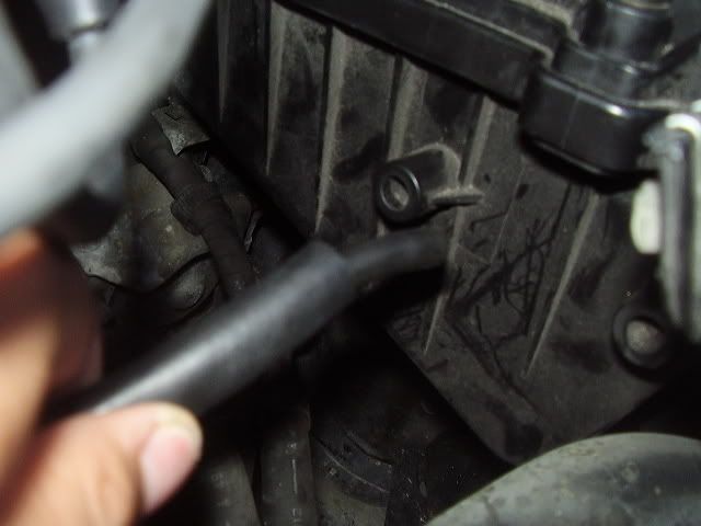

lol sorry my camera died the battery is being recharged , any way i looked and looked , iu found nothing but i hear a hissing noise near the air intake box and it hisses when i turn the car off ............ so most likely it connects to something else other then the maifold
the hose starts from here or ends there but in this situation starts

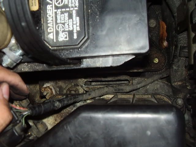

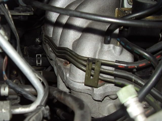

here are a few badpics
this is where we first thought the hose went
http://i41.photobucket.com/albums/e294/ ... 070146.jpg
that is where the hose starts
http://i41.photobucket.com/albums/e294/ ... 070148.jpg
and conencts to the big silver thingy
and that is behind the air filter and in front of the battery

i have no clue what to tell you bro, we need more opinions, but im dedicated to helping you out, circle all the points in those pictures and repost them, also your air box is hissing cuz its sucking in unfiltered air from that hole. also ill try and find you the plug wire pattern as soon as i can, probably not tonight tho.

[quote="shameem"]The hose goes here -
[img]http://img476.imageshack.us/img476/526/image1hy1.jpg[/img]
Usually there is a small plastic nipple there for the hose to plugged into the airbox - but in your case it seems to have broken off... I think i see part of that broken plastic still stuck at the end of the hose. Some JB weld and tape might help stick it back...[/quote]
dude its 8 42 am im sleepy as hell late for class and you saved me lol i just got back from my car and you are right thanks man
from my angle it looks like a screw any way i need remove the stuck piece i will ry andpost pics thanks shameen
