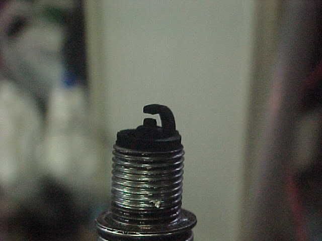

take a look at the plugs :shock: so rich

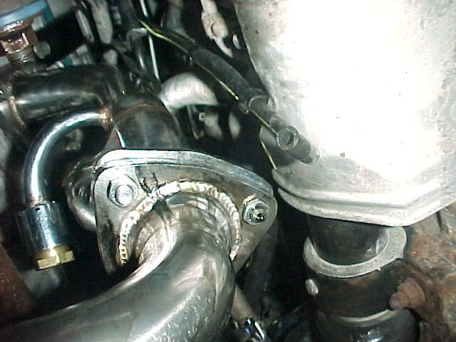

this is where it was leaking the most

I don't suppose your running an AFPR are you? Perhaps it's set to high.
babyblueMX3
Posts: 3755
Joined: February 23rd, 2003, 2:01 am
Location: Gatineau,Quebec,Canada
Post by babyblueMX3 »
nope. stocker

I found what the problem was..all of the bottom o-ring of the injectors were bad :roll:
