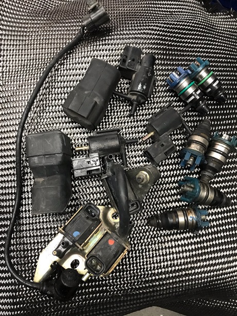

NTK crank sensor - Code 2 and random complete loss of power/rpm after warm up
A new set of Injectors (Mx-6 Blue) -Apparently the old injectors were rebuilt once (dated 11/18/03) And sadly, 2 of the new injectors came out of the box DOA :? Replacements should be here Tuesday
Working VRIS solenoids - Thanks SE!
Working EGR solenoids - Thanks SE!
And for the first time in a couple years, no CEL.
