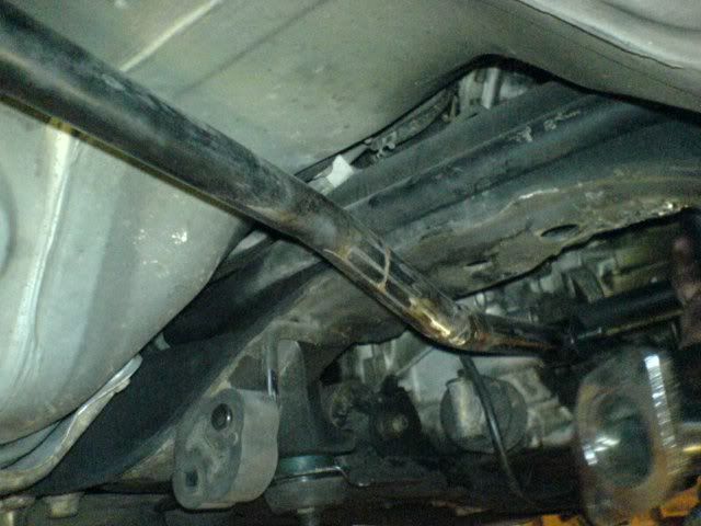

picture of modified bar:fowljesse wrote:14 hours of fun! Wheeee![]()
We cut, and reshaped the shifter bar that keeps the shifter assembly at the right relationship to the tranny, because it was too low for the Y-pipe. Since my engine is stabalized, and doesn't really move, we were able to cut down the clearance of this bar by about 1.5 inches. I was concerned that shifting would be affected, and it wasIt's more precise!

We cut about 2" from the bottom bend, and straightened the top bend to about 5 degrees, and welded it back together.

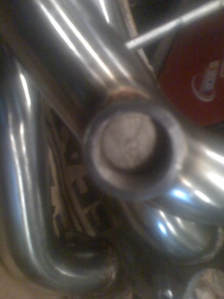

I deleted the EGR, and had to close the holes. I remembered a mod on oldskool VW carbs, where you plug a dime into a hole. I looked through my change (which was only 1 Nickel, and a penny), and luckily, the nickel was close to the right size. I shaved the edge until the lip was gone, and stuck it in the bunghole, and tightened the compression hose fitting (without the hose) down on top of it. It works great, and cuts down the turbulence there, since it's fush against the tube.
Here's a bad cellphone pic:

Is this the bar that doesnt move or the one that actually changes gears? LOLz...I wonder...is there any way you guys to make a modified shifter thingyfor me? Mine got bent when I stupidly left it attached to the engine when I pulled out my 1st ZE (bad headgasket and I was rushing) I bent it back a little but shifting isn't perfect. My rubber bushing is also destroyed so that doesnt help.

It is the bar that doesn't move.onlytrueromeo wrote:Is this the bar that doesnt move or the one that actually changes gears? LOLz...I wonder...is there any way you guys to make a modified shifter thingyfor me? Mine got bent when I stupidly left it attached to the engine when I pulled out my 1st ZE (bad headgasket and I was rushing) I bent it back a little but shifting isn't perfect. My rubber bushing is also destroyed so that doesnt help.
You'd have to ask Cjthor about that. It would be alot more cost effective to get a J/Y one, or put up a [WTB].
Try replacing the bushing first. That may fix it.
