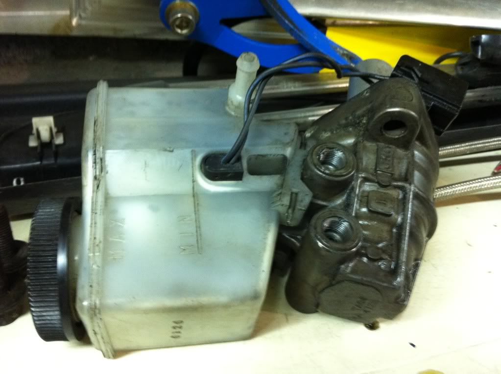

What is a good way to route lines around the master cylinder to the other side?

mitmaks wrote:What is a good way to route lines around the master cylinder to the other side?
I would go to the local parts store and grab new lines, borrow a bending tool and replumb them underneath the the M/C. You might be able to rebend the existing hard lines...but that would be dicey.

Is there a how-to thread on installing Millenia master?
Re: Millenia Master brake cylinder
Post by Josh »
mitmaks wrote:
WhiteFinish wrote:I've purchased some millenia brake lines , but will not install for some months... I'll post my results here.
I do not believe so. I was looking into that one recently as the 98' Millenia uses the same style master as the GS the only other Mazda car I could find that did, but uses a 1" bore vs the GS 15/16". the problem is that the milly has a rod depth of 1.05" and the GS has a rod depth of .663 so I would assume that you would need the rod from the Milly to do the swap. ALSO the milly has the ports on left and right sides where the GS has them Right front and right rear.
The easier swap is going to be to the 94' 929 master that is a 1" bore and has both ports on the right, but this one may entail using a different booster. I have yet to confirm that or not.
The caliper does not need the knuckle modified, you make a bracket to go from the pre-existing mounts to that of the caliper. Some people have had the tabs on the caliper itself cut off and relocated to mount up as they are aluminum and easier to weld than cast iron.
