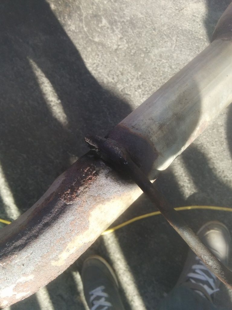

Just an update guys, my friend and I swapped the exhaust (which was a pain in the a--...had to dent in the oil pan a little to get the down pipe to clear...it's sitting tight against the oil pan now) and I discovered why it idled so poorly. I've attached pictures this time! In one of the spots on the stock exhaust where a hanger is welded on it had completed corroded, it was just held in place by rust and maybe 1/16" worth of steel. After taking the stock exhaust off I was able to just twist that hanger right off. The car is running beautifully at the moment, but still throwing those O2 and EGR codes. I don't remember how the EGR is attached to the engine, my friend connected it while I was under the car bolting the manifolds on, but he said it was pinched so it should still work. When I start the car, there's no codes, but when it warms up the CEL comes on but the engine still runs, drives, and accelerates like normal. I haven't checked the code, I'm just assuming it's still the same codes as before. Is it possible that the wiring from 93 to 94 for the O2 sensors to the ECU or how the ECU reads the O2 sensors was changed? I never had those codes with the old ECU and the old exhaust, so the next time I go home I'll be drilling and tapping a hole for the extra coolant temperature sensor, wiring it back up and switching from the 94 ECU back to the 93 ECU, and I'll see if that helps. RX8SE3P I'd rather not spend 100$ on new O2 sensors if it's not the issue! :P But then again they could be the issue and will need changing anyways...or maybe I need to switch back to the 93 ECU cause they made more changes than I thought they did...Stupid Mazda

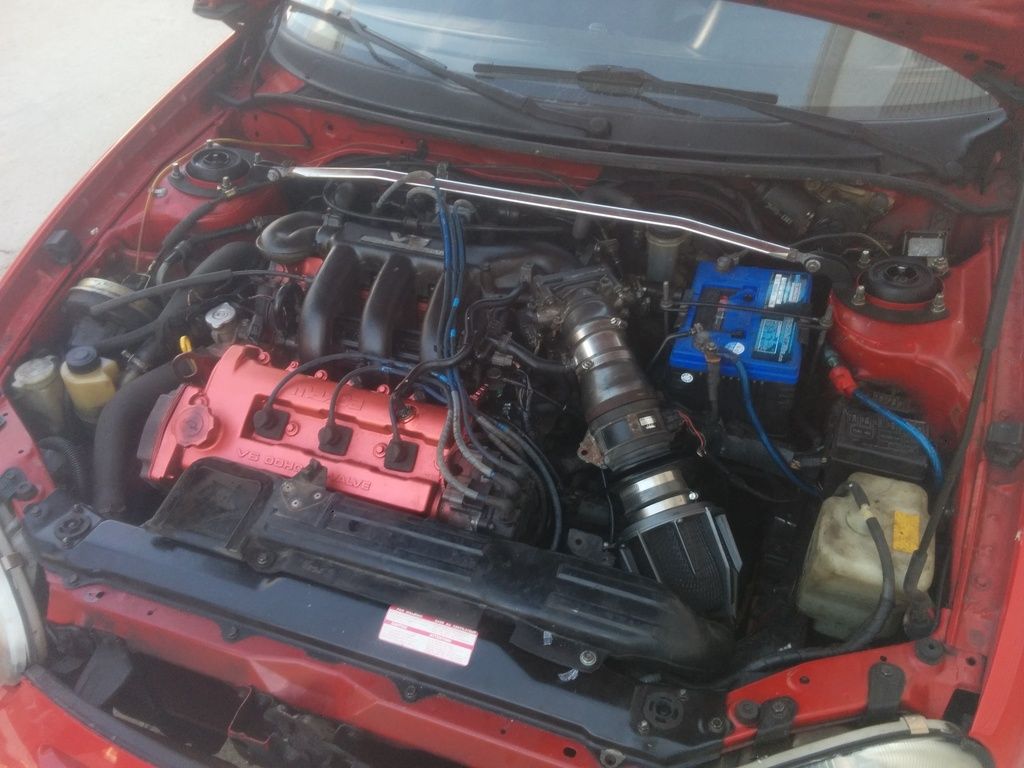

And the mod from the weekend, painted valve covers and intake manifold!! :D This was supposed to be an easy job....unfortunatley I also broke a fuel hose and fuel kept leaking from the banjo bolt you have to remove to take the IM off. Lost quite a bit of fuel there.....but it looks sweet!! :P "Powered by KLZE" oil cap is also in the mail, should get it in the next few days to top that mod off. Car is starting to look awesome :) This weekend: change rear brakes (one caliper pin is seized and pads are wearing unevenly and not grabbing properly), change rear strut mounts and adjust bottom spring seat to get rid of the noise from the rear suspension. Fun times! :P

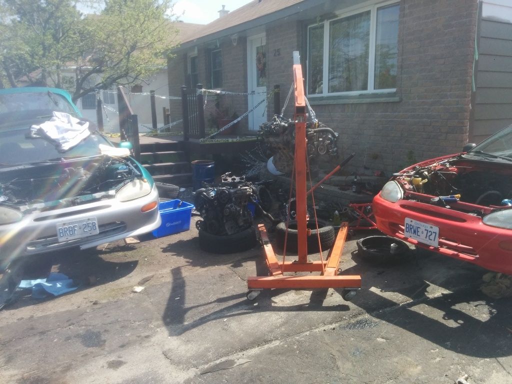

Now for those interested, PICTURES!! :D
Green/Silver donor car, body, frame, and tranny no good. Engine, shift linkage, short throw shifter in good condition
Just about ready to pull. My friend's first time pulling out an engine, he was pretty excited
Engine out, he's pretty pumped :P
my second time pulling one of these bad boys
Timing belt and idler pulley work
both engines out, swapping commencing
working tranny on better engine, my local MX3 wizard helping me finish the job, the donor car was his before I bought it off him. Other friends Mazda 3 had its rear suspension collapse, he was on his way back to help us install the new engine, he never made it :(
engine was in place and all mounted around 10pm :)
Don't have any pictures after the swap, I have a video of us starting it up with no exhaust connected. That ZE is LOUD with headers and no other exhaust connected :P If enough interest is show I can upload to YouTube and link it here. We also gutted the power steering system from my car, the donor didn't have power steering, the wizard had disconnected it and made it manual steering, as his power steering was either always making noise, leaking fluid, or just not working. Mine had just started leaking, power steering fluid with stop leak had stopped said leak, but I didn't want to deal with future issues. I had also use the reasoning at the time that "Race cars don't have power steering".....I miss power steering. The one issue that prevented us from starting the car right away after connecting everything: distributor. Don't EVER take your distributor apart and clean the contact points. Once we figured out that was the issue, we swapped the distributor over from my old ZE and it fired right up! :) So, I guess the original issue that caused the creation of this post has been fixed. It only took an engine and ECU swap to fix ;)
