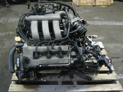

Any one got a pic of the "old" design klze's Oil pan?
Or can confirm that this one is an oil pan most klze's have?
Or is this the one? Or is this the redesigned ("new" KLG4/KL 2000+) one?
By old i mean this type, tube on the front valve cover:

As far as I know all KL oil pans are the same, the valve cover is a different story. Ford/mazda redesigned them mid production to remove the front breather tube on the KLG4 variants and some probes had a TSB done to remove them, thats the same front valve cover I use on my car to reduce the amount of vacuum tubes.

I've read a few times that the newer ones are supposed to be different. Redesign because nr 6 bearing often spun.
In the pics they look different, or is it just the way the pic was taken? Now that i look at it again, there a the same i think. -.-
I can't seem to find a pic of the new oilpan design.
