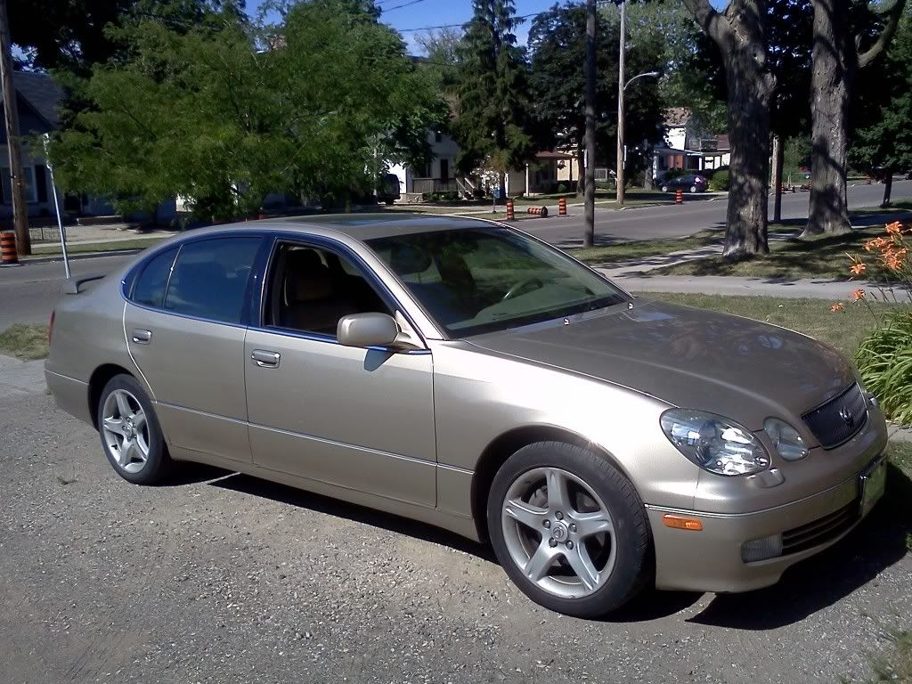

A 1998 Lexus GS400 which is my current daily driver. It's all stock, and I love every little bit of it

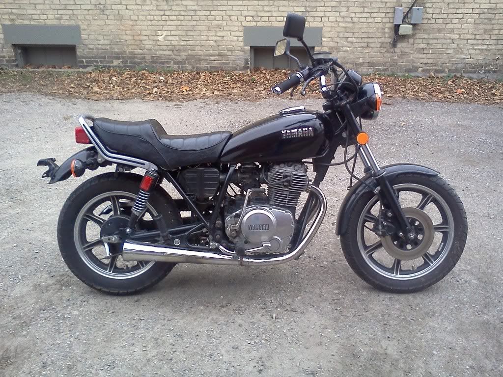

And my summer toy/wallet-muncher:
A 1982 Yamaha XS400. Since this picture's been taken, it's been modded out the bum with K&N-style intakes, high-comp Seca pistons, a lighter XS360 crankshaft, megacycle cam, stiffer valve springs, rebel shocks, clubman bars, custom flat-seat, upgraded braking system, lower ratio final drive, and free from all unnecessary mass. Oh, and it's still kick-only so my right leg is jacked...
