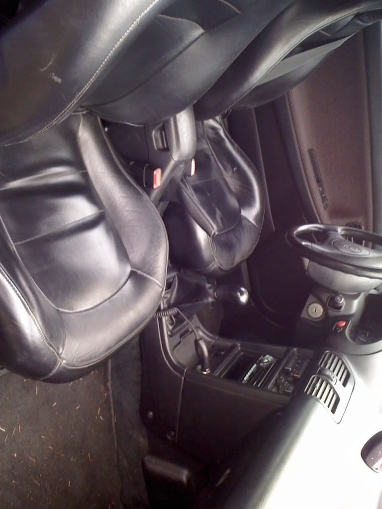

I'm curious where did you get the leather seats? I have the same ones in my car but I thought they were not OEM mx-3 leather seats...

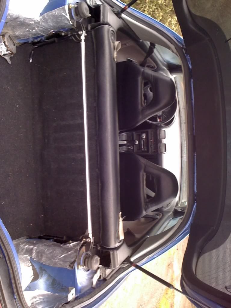

You do know that for the rear strut bar you can still leave the panels in. Just cuta small notch in them for the bar to come out of.

Mooneggs, I got the seats from a guy on here. I don't know anything about them, and don't know if I'll get a chance to ask, as he owes me a bunch of stuff as part of the same deal.

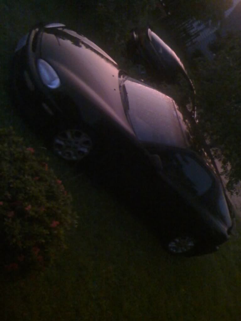

I checked off the first thing on the list. I wanted to see what this car would look like in flat black. There were a couple on here over the years, but the body work wasn't very good, and the paint wasn't buffed out, so you could see the spray pattern.
My buddy Mooneegs came over and helped, but don't call it Moonwax, because it's actual paint, not primer :D
The paint needs to be color sanded, when it's cured. It will look alot better when sanded, and waxed, but here's how it looked when the rain started.
Thanks, Mooneggs for the clear signals, and markers! When it stops raining, I'm going to buff them crystal clear.
I was looking at the sunset, and thought this would be a nice picture.
I took this with my cell phone. I wish I knew how to use my girlfriend's new digital SLR :(
One day Cjthor said I could use his paint booth. Then the car will be a black mirror, but this will do until then. Hopefully, it will make it harder to get a fix on with a radar gun :wink:

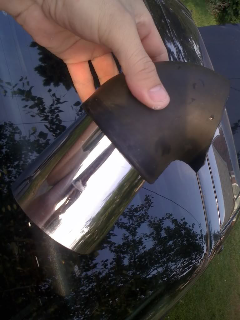

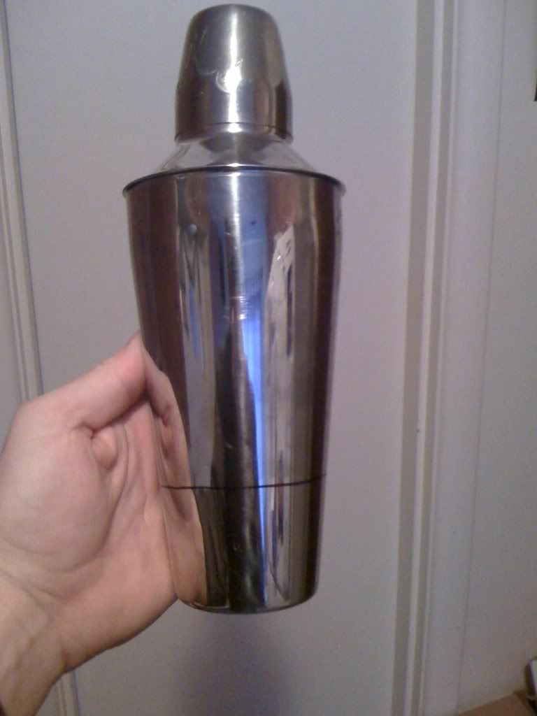

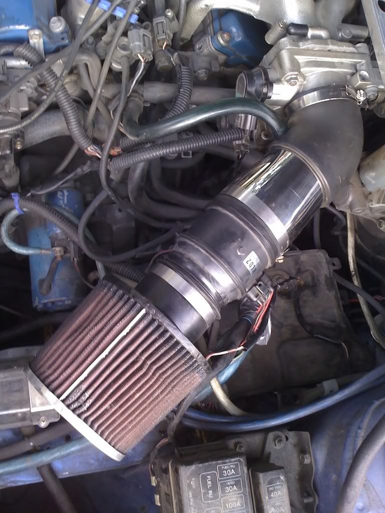

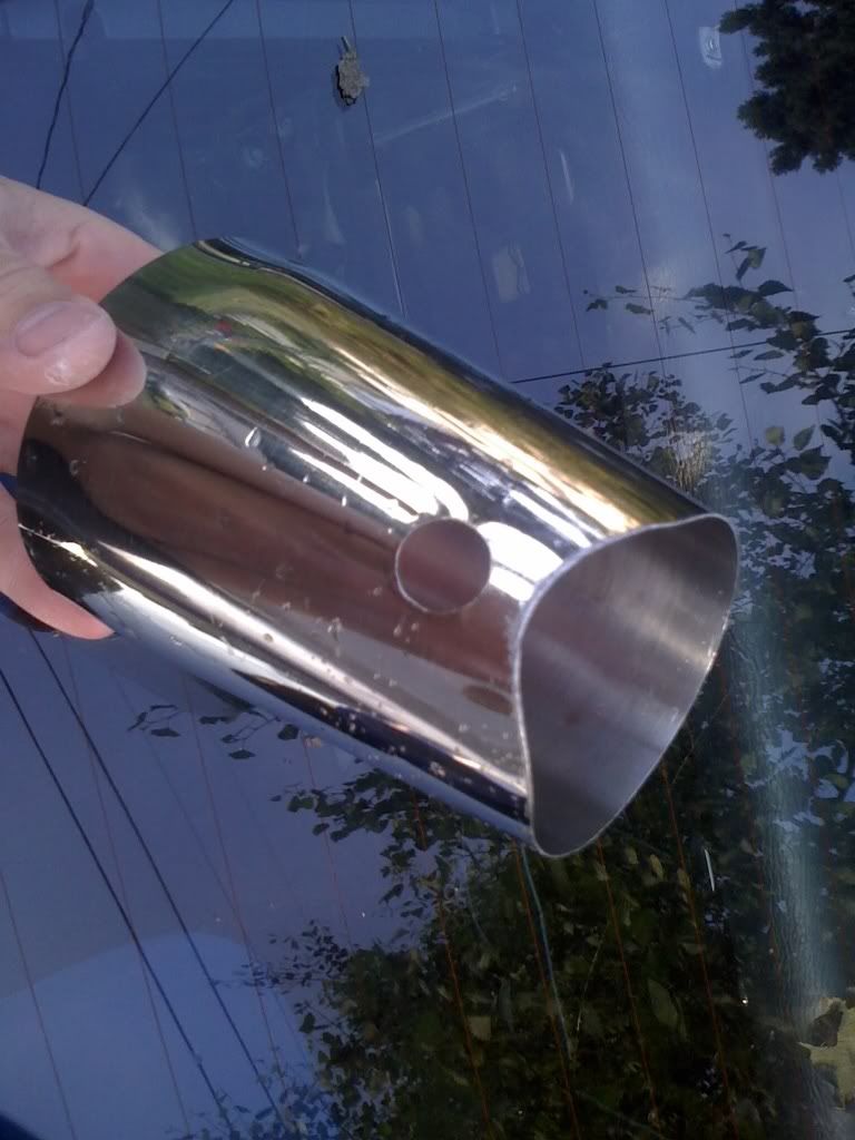

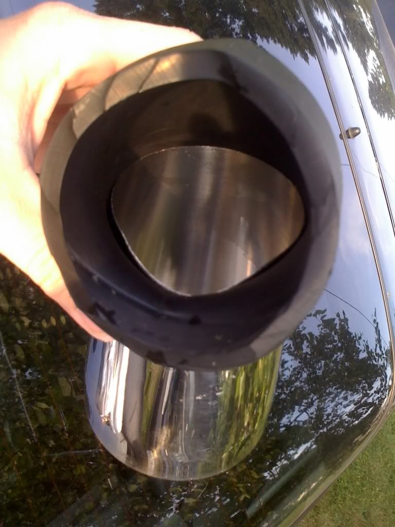

I relocated the battery, and redid the CAI. It's now a WAI, but will soon be a RAI. Ever since I made my first CAI, I became obsessed with smooth airflow. I wanted a smooth transition from the IM (2.5'') to the MAF (3"). I knew right away what I wanted, but settled for a thrift store cup, until I found a thrift store Martini shaker. Here it is with a line drawn for the 2.5" cut. The other end was already 3". This is a great mod for any intake to replace the faulty, and turbulant accordian hose.
Here it is after I cut, and shaped it, and drilled the hole for the PCV line.
I shaped it that way, so that when I put it into the reshaped 2.5" to 3" elbow, it would flow well.
Side view
Here it is complete
From further away
You may say "Fowljesse, why did you take it out of the fender, and make it a WARM air intake?". You may even use expletives. The reason is; It's in perfect position for my next step. I'm making a ram air opening out of the headlight hole. "But, Fooljesse, you'll get pulled over for not having the light!" Well.. I'm getting a smaller light, that the air will go around. There will be pictures when it's done.

jesse, maybe im just beeing an a--hole ... but ...
If you made your CAI to go into the fender, u could still make a ram air intake ...
When you put the intake filter inside the fender, it stays in a hole that is covered by the headlight
If you are making a smaller headlight, or a headlight made to let air pass inside in, redirect the air into the hole.
That way u get 2 in 1 , a Ram Cold Air intake :mrgreen:
