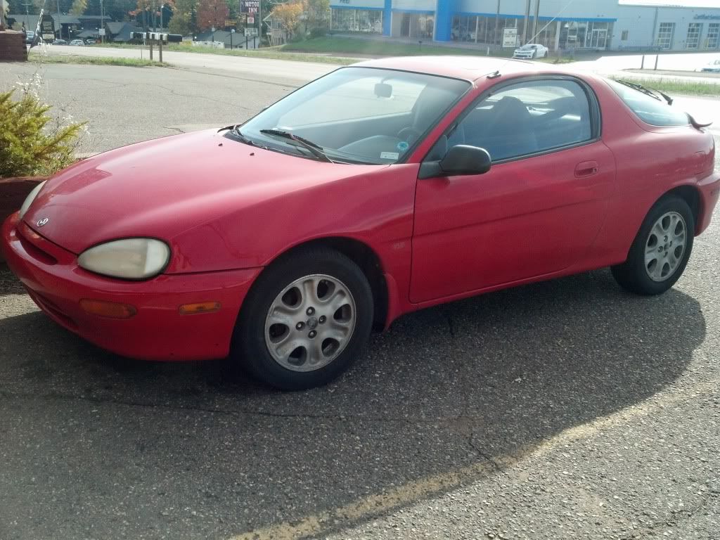

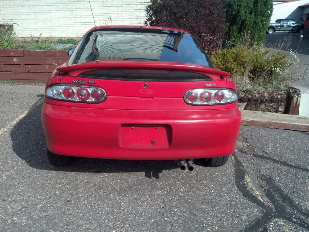

I'm Allie, and I'm from Michigan's lovely UP. I just bought my MX-3 yesterday.
She's a 1992 GS and she is quite the switch from my lifted Jeep Cherokee! That was the point of buying the Mazda, actually. I like my Jeep, but dang I'm tired having to save up for months in order to drive downstate to visit family. I snagged her for $1500 and the guy met me at the bridge rather than me having to haul all the way to, like, Muskegon. So anyway, I thought I would join up so I could start figuring out what things I need to do to get her running correctly, as there are some small issues here and there.
Photos. Everything is as the previous owner had it. I've only had her a day!

Welcome to mx-3.com. Looks like good little project. It should clean up nicely. I'd pressure wash engine to get rid of all that dirt/gunk. Looks like valve cover gaskets are leaking so replacing those would be good idea.
