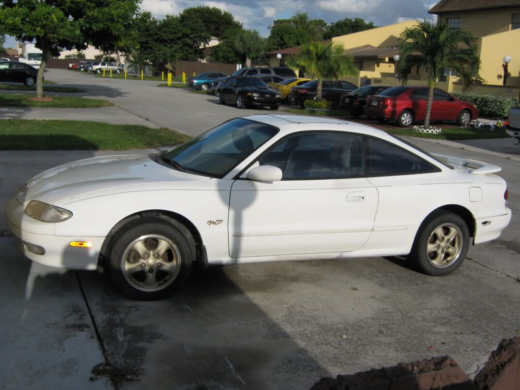

This is a pic of the car some of you already know. More to come.
