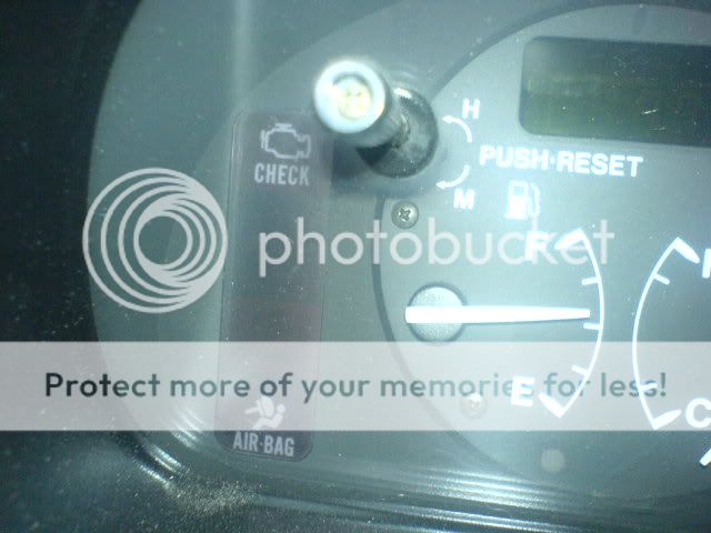

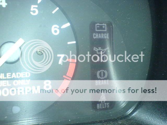

As far as your airbag question first I have a question for you:
What country are you from and is your steering wheel on the left side or right side of the car?
Are you sure there are airbags in the car? there should be something on the steering wheel that says "SRS" or "Supplementary Restraint System", as well as something on the dash in front of the passenger seat that says the same thing...
There is no switch to turn the passenger airbag on or off (like newer cars). As far as I know the only indicator that the airbags are working correctly is when you first turn the key on an airbag light should illuminate but then stay off once the car is started. It's possible the bulb is burnt out (common problem). If the light stays on or blinks I believe that's the indicator that there is a problem. If there truly is no airbag light and there ARE airbags in the car then yes I would also assume the cluster has been swapped with a pre-airbag mx-3 model (probably 92-93). I believe Euro clusters may have a different configuration and different warning lamps but here is how North American clusters look:
Left Side warning lamps:
Right Side warning lamps:

I went to the car and took a few shots with my Blackberry (its already night).
No airbag light.
No seatbelt light.

So you definately have airbags and no airbag light... hmmmm I wonder if there just is no airbag light on Euro mx-3's? I have never seen the seatbelt light on a Euro mx-3 either I think that's an NA option only.

If you car is newer than 1994 (which all evidence supports, including dash style) That is the stock motor. No one swapped the valvecover, because there isn't another motor with the same head. They're all B6DE's.
The cluster may very well have been swapped from a non-cruise car... but if they went to that effort, it would take 5 extra minutes to wire the airbag light back in.... :? Maybe someone here can ship you the panel with the airbag symbol, you can put the bulb in, and its all fixed.

The seatbelt light is probably US-only, but there should definitely be an airbag light.

Your RPM gauge redlines at 7000 RPM. Since you're car is 94 or newer, the cluster has a digital speedometer cable, and could only be exchanged with another B6DE cluster, or a GS cluster. Since the B6DE redlines at 6.5k, your cluster is from a V6 MX-3, where any year is possible, air bags or not.
