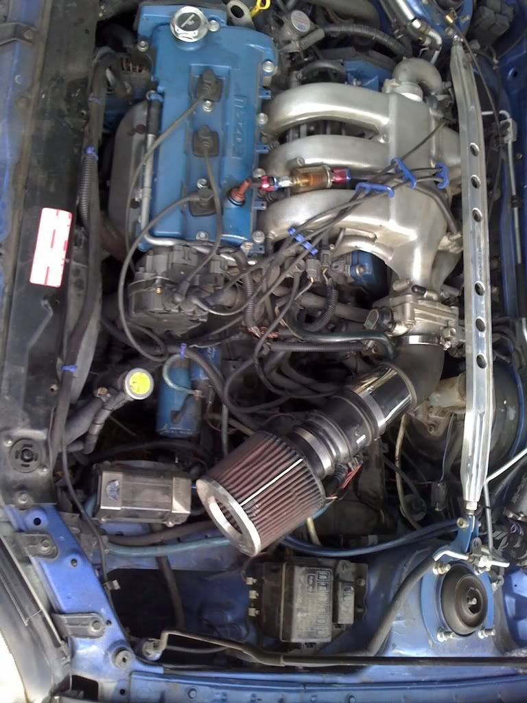

- 2.5 liter KLDE engine
- true ram air with intake where the turn signal was.
- Customised K&N air filter with air tight box, and 4" hole, instead of 3, that tapers down to about 3".
- Custom 45 degree elbow from the Throttle body with about 3" diameter on the other side that connects to the air filter. It has a GM airflow sensor in it.
- Bored Throttle body 65mm with IAC deleted, and a coolant temp sensor in it's place. TB has the linkage turned upside down, so the Intake manifold clears the brake master cylinder.
- KLG4 Intake manifold from a 2002 Mazda 626 that has been ported, and has customised VRIS points.
- Phenolic IM spacers
- Ported and polished heads (with KLZE exhaust cams) that are port-matched to the IM, and Headers, and throat ported.
- 10:1 compression pistons on a balanced rotating assembly, and oversize main bearings.
- Ported Pacesetter long tube exhaust headers with the front flange deleted, and the tubes welded.
- 2.5" exhaust with only a FlowMaster HushPower muffler, catalytic converter, and one (Mandrel) bend to side exit.
- Solid motor mounts, and AWR Transmission mount.
- Unorthodox underdrive pulley
- Exedy clutch
- Customized engine torque strut made from one for a 240sx.
- MSD 6A box
- MSD Blaster2 coil
- MSD Super Conductor wires, 50 Ohms/ foot, shortened about 6 feet
- KLZE distributor
- Indexed plugs
- MegaSquirt and Spark engine management system.
- Custom catch can that lets nothing but clean air into the IM
- H&R springs on Gabriel struts (about 1.7" drop)
- Aluminum engine crossmember, and rear tie bar.

I bought lakersfan1's car, and want to give him credit for the work he's done. I'll first list the mods he did (to the best of my knowledge, as I am awaiting a list from him). Then I'll show what I've done, and update once in a while.
- Engine -
He completely rebuilt a ZE bottom end, and put on DE heads with ZE cams. It has an '02 626 IM, chipped DE ECU, balanced crank, .050 over main and rod bearings, chrome piston rings, Jap-spec 10:1 pistons, Jap-spec exhaust cams, main and rear seals. Just installed two years ago - 10,000 miles on the engine. Gets over 200 PSI compression on 5 cylinders, and 190 PSI on the 6th cylinder, and filled motor mounts. It has an Exedy organic clutch that grabs hard.

I relocated the battery, and redid the CAI. It's now a WAI, but will soon be a RAI. Ever since I made my first CAI, I became obsessed with smooth airflow. I wanted a smooth transition from the IM (2.5'') to the MAF (3"). I knew right away what I wanted, but settled for a thrift store cup, until I found a thrift store Martini shaker. Here it is with a line drawn for the 2.5" cut. The other end was already 3". This is a great mod for any intake to replace the faulty, and turbulant accordian hose.
Here it is after I cut, and shaped it, and drilled the hole for the PCV line.
I shaped it that way, so that when I put it into the reshaped 2.5" to 3" elbow, it would flow well.
Side view
Here it is complete
From further away
You may say "Fowljesse, why did you take it out of the fender, and make it a WARM air intake?". You may even use expletives. The reason is; It's in perfect position for my next step. I'm making a ram air opening out of the headlight hole. "But, Fooljesse, you'll get pulled over for not having the light!" Well.. I'm getting a smaller light, that the air will go around. There will be pictures when it's done.

jesse, maybe im just beeing an a--hole ... but ...
If you made your CAI to go into the fender, u could still make a ram air intake ...
When you put the intake filter inside the fender, it stays in a hole that is covered by the headlight
If you are making a smaller headlight, or a headlight made to let air pass inside in, redirect the air into the hole.
That way u get 2 in 1 , a Ram Cold Air intake :mrgreen:
