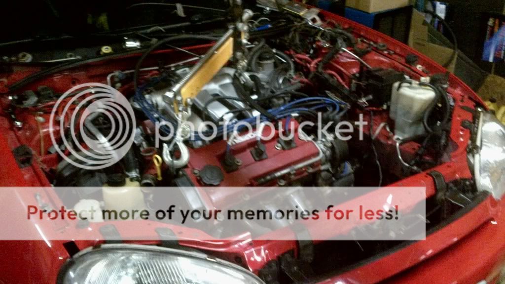

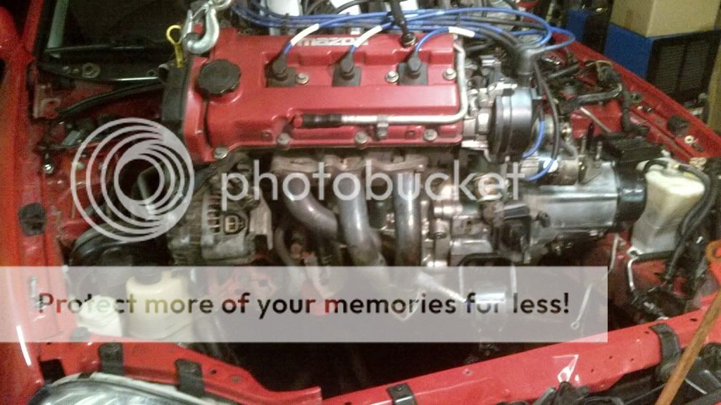

Ok I installed the headers and I might say It was a pain in the butt still need to do some more on them at the shop. I decided to do it at my house this was a bad Idea.

Loving the Car...... Any reason why your not running a dust shield on your tranny?

Ya I had to remove the splash shield to do the install.

Sorry, I thought you meant the undercover shield I just unbolted the transmission cover to see if their was a oil leak coming from the transmission.

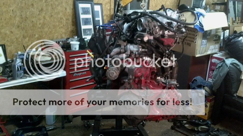

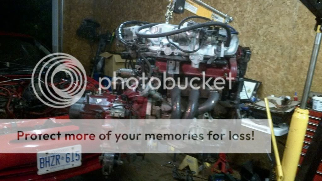

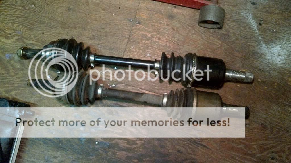

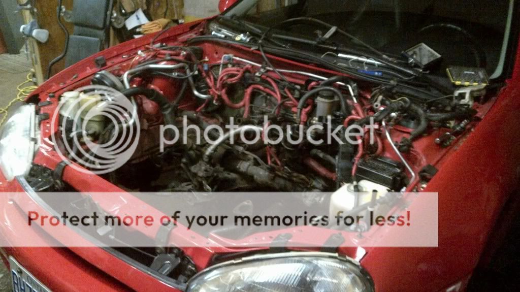

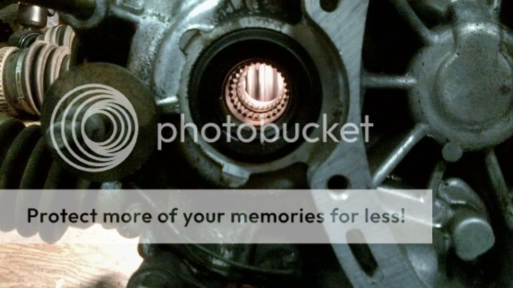

Haven't done anything on the car in a while, been very broke. finally got enough saved to do the LSD install after buying it from john. Their was a few obstacles to overcome before I installed it, #1 the axles especially the drivers side i have pictures to compare the original G5M-R axles to the new LSD transmission axle ends. I took the axle ends into a so called specialist and he told me he could find the right length shafts and use the LSD cut ends with some Mazda Familia spindle ends he got by accident a few years back. Well i got the axles off him at a cost of $300 per side, expensive ordeal I might say. #2 I tried putting the drivers side axle in and guess what it's 2" too long the joints bind together when installed :evil: . As for the passenger side it installed flawlessly. So I decided to use my old drivers side axle for now until he can find a shorter shaft. check out the pictures.
Comparing the differences of LSD axle end to original
Length difference
All my assortment of axles
Engine out
My new LSD transmission
Showing the NO bar through the LSD
Empty engine compartment, I spent some time cleaning a few things because of the gear oil leak.
After 10 hours of work engine is now going back in.
So I also have about 70 pictures of the entire process of my car getting painted but just too many to show so i am going to upload a few tomorrow. On top of that after a month out of the shop some dirty A-hole hit my car in a parking lot didn't do much damage but threw the entire front end out of alignment, the bumper (which needs repaint AGAIN), hood and fenders :evil: This is been a shitty month for me after spending a lot time and money painting the entire car. It's been a deciding factor for me you CAN'T keep anything nice anymore, people don't care for your property and this pissed me off dearly. Quote is $800 to re-align and too pull the front end into place :? . Not even a note left on my windshield and my deductible is $1000 :crying: so out of pocket again, I have a big target painted on my car I swear. I'm going to show pictures tomorrow as well.

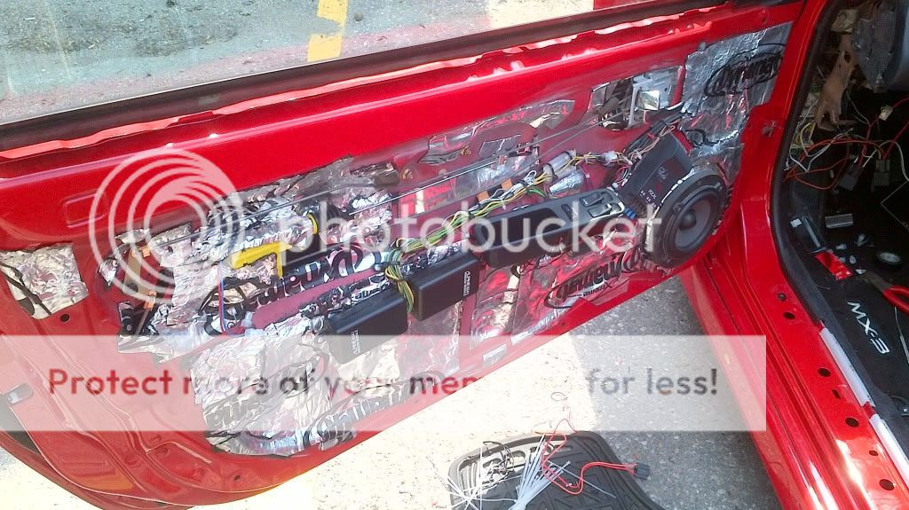

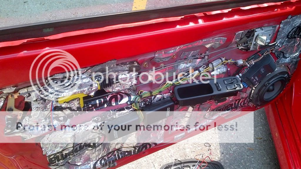

Here is my Alpine 8341 Window module installation, 1 module makes the windows go up when arming the alarm and second one makes them go down on my alarm when the EXT 1 is pressed. I tried to make it clean install, their was enough room to fit it in the door in the armrest cavity to try to keep it as close to the switch as possible. Also had to diode insulate the trigger wires so I took me quite a few hours to make it super duper good :lol: Also you guys notice the focal crossover location I found a nifty location for it as well.
Also on the list is I need two more 8341 window modules to fold the mirrors in and out when arming and disarming, as well as sunroof close if it is opened when arming. If anyone has any they are willing to sell me please PM me thanks. :mrgreen: I didn't take any pictures of my Alpine SEC-R150 install it was an epic install too with radar sensor and shock sensor. Also i wired the relay to be normally open so come on thief's try and find my alpine module and relays.
