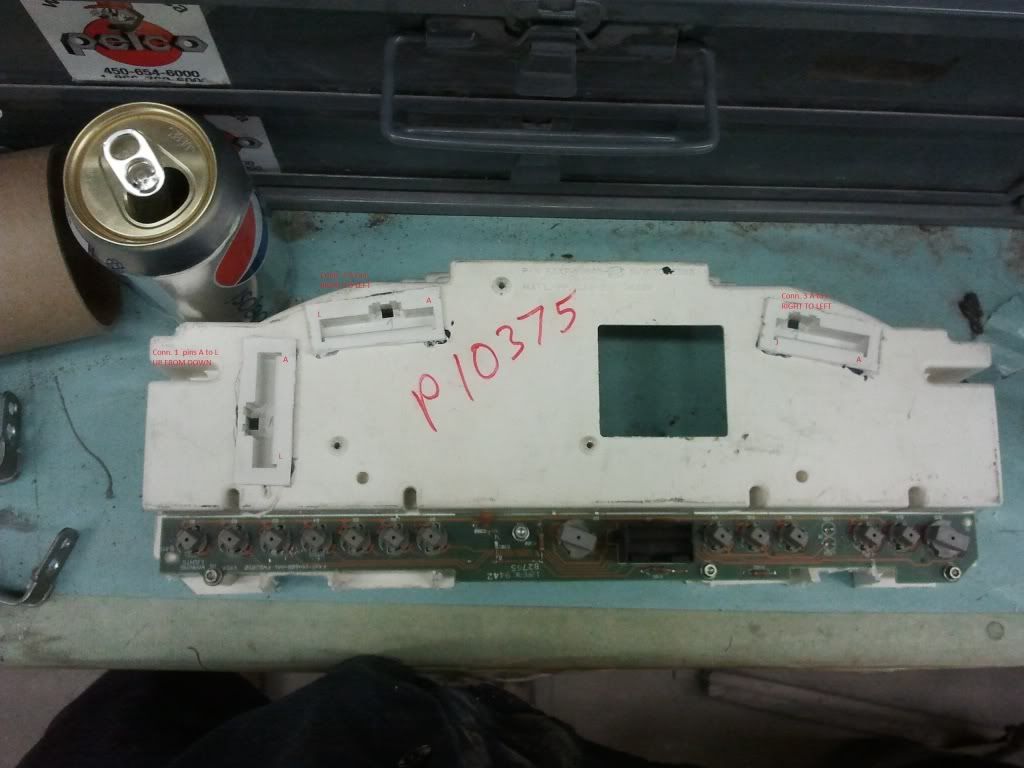

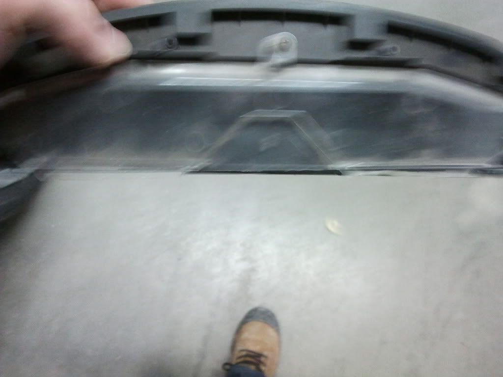

First we'll start off by dissasembling the Mx-3 cluster and salvaging what we need. we'll need the black oval ring so be sure not to break it.
With the black oval off, you're to have to remove the leftover plastic that goes beyond the back to make it flush so we can glue on a plexi right on it.
As for tinting, you can use a blue fitler(which i havent found yet) then a limo glass tint.
Then on the white housing. we'll only be using the connector holes so we can actually plug and play the cluster once it's completed. Now on the digital cluster housing, Youre going to have to remove everything in it and start drilling holes to put the connector holes. Try to be as close as possible as you can to place the connectors because you dont want them hitting anything when you put the cluster back in the dash.
once you're sure about the location, put back the first piece of the digital board and make sure nothing hits anything.
now on the digital cluster housing, we're going to cut everything we can that will get in the way
you can cut where the black hoels are and the red holes will be welcoming the positiong bracket that holds the cluster in place.
for the warning lights you have to cut the lower corners and make sure you cut the same rectangles as in the previous picture to clear the bracket holes. then just put 1 screw on each side. you might ahve to cut through the black oval so you clear the two screws you just put in. and to hold the new plexi glass, 4 screw should do the job.

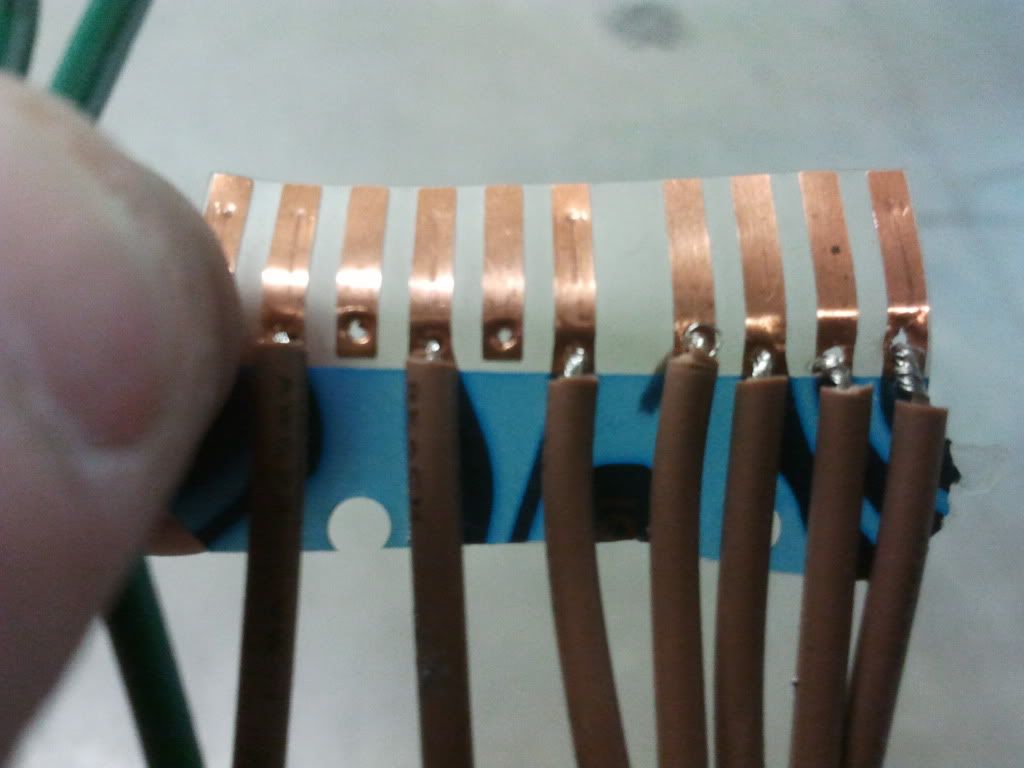

Now on with the electrical stuff.
First, we'll be cutting te tracing that goes in the conenctor holes of the mx-3 cluster. then we'll pierce holes on all of them that are needed.
Once this is done, hot glue the back and solder the front to make sure contact is made properly then hot glue on top of it to make sure that you dont get short circuits.
then you can just glue the new tracings into the connector holes. this way your digital cluster will be plug and play.

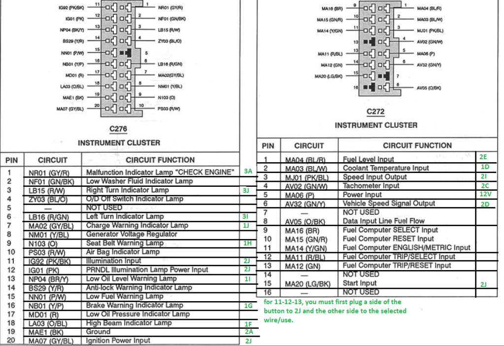

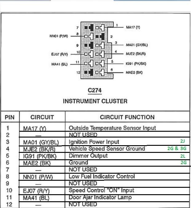

Now, to make this easy, I've put up three pictures that you will understand properly(hopefully)
Well, this is it.
FinaL result looks like that
Pleases be sure to check your connections before plugging it in!!
Double check if you have to. There is a cluster diagram on mx-3.com and for the villager please go here
http://www.xtremethings.com/Engineering ... luster.pdf
