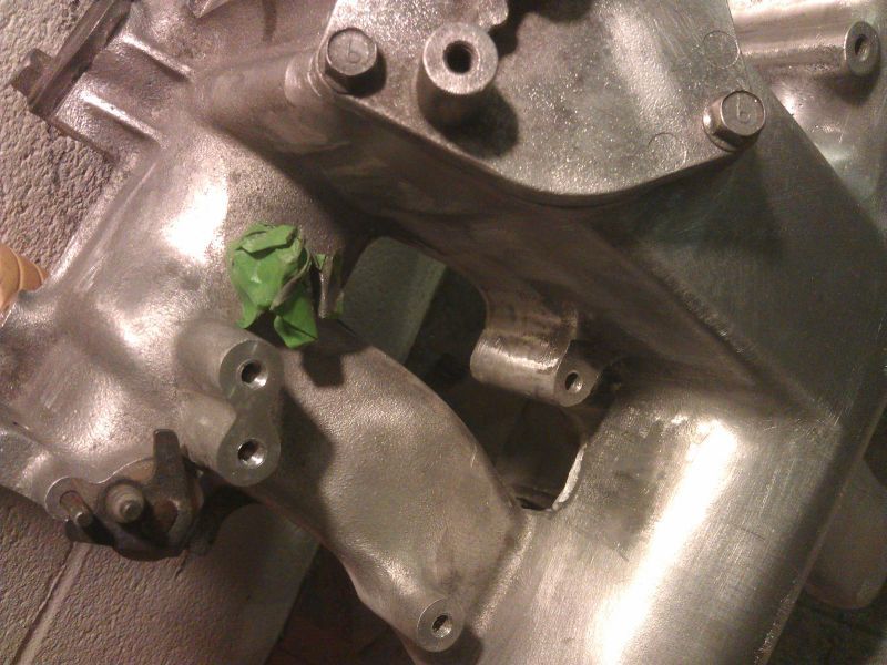

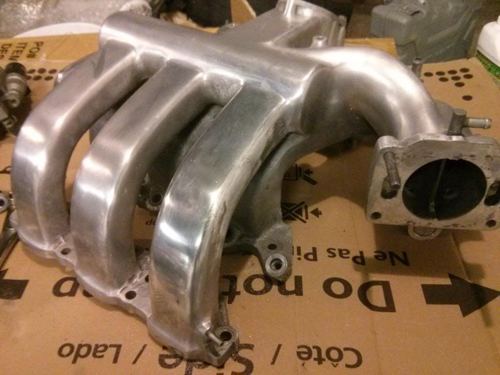

did a little more grinding.
Think that took about 2 hours.

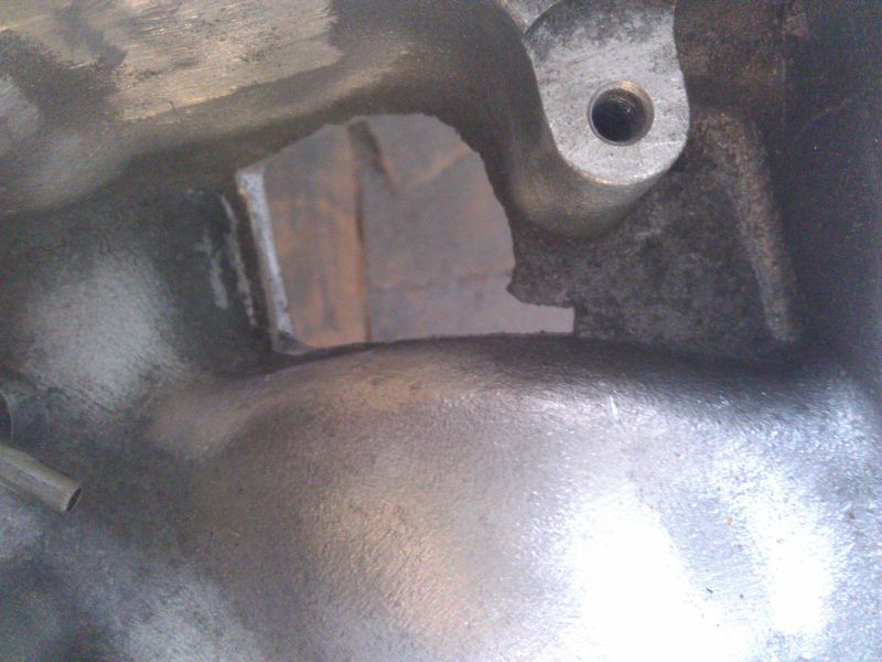

Did you grind out all that flashing or cut it out. I've found you can take out large chunks of aluminum pretty quick by drilling into it with a large sized drill bit. (start with small bit then get progressively bigger.) Or if you have a pneumatic body saw that could help too rather than grinding away at that stuff.

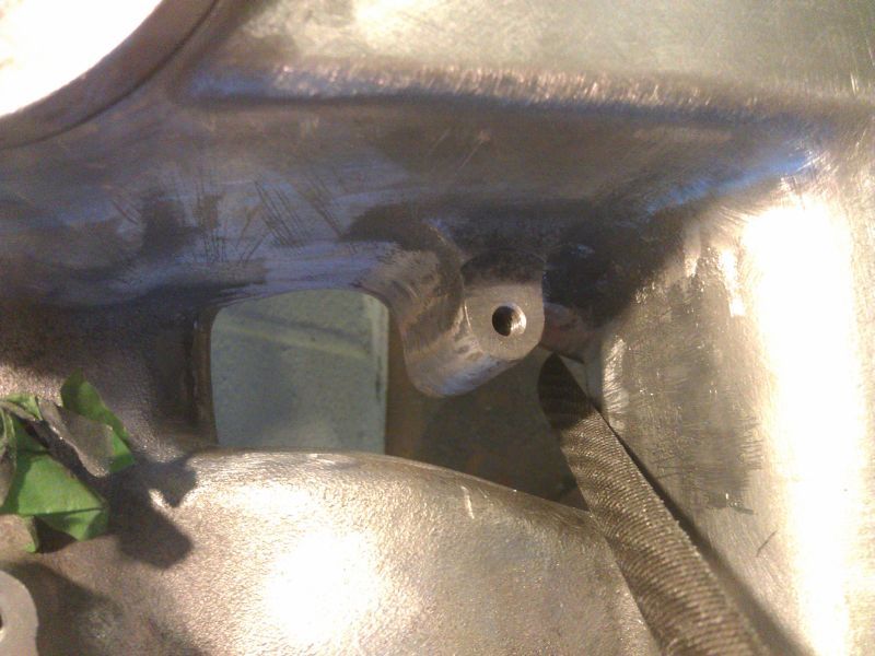

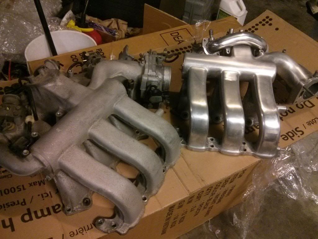

Haven't given up (yet) on this thing.
At one point I got discouraged so I started polishing just a corner so I wouldn't get discouraged.
That gave me a little more motivation so I kept working at it.

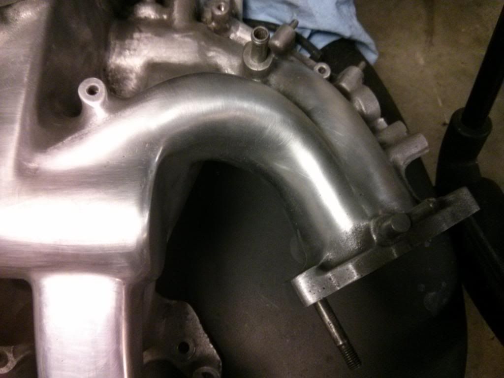

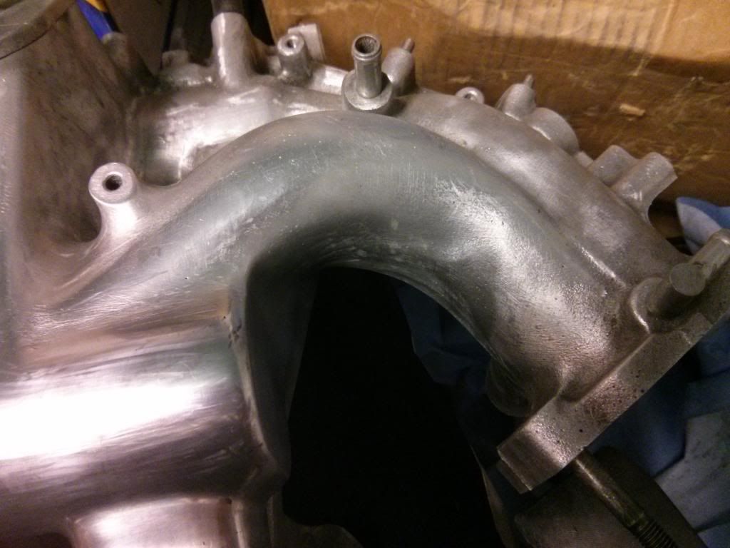

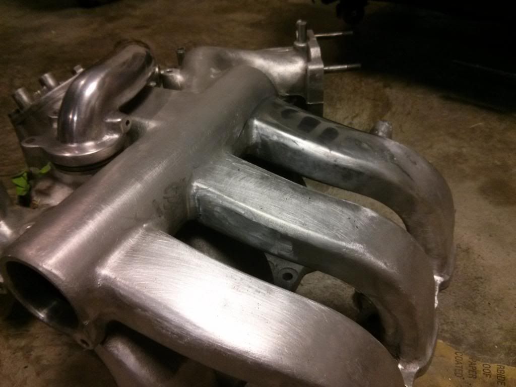

I then focused on the neck of the intake:
Before:
After:

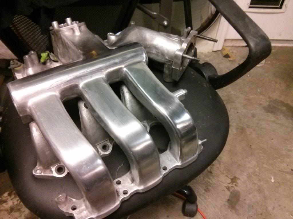

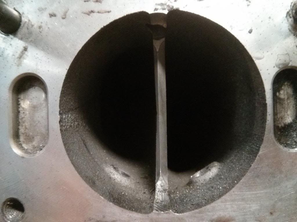

Comparing it to the Millennia intake, I am beginning to be pleased with my progress:
Seems like the intake throat of the Millenia manifold doesn't have a knife edged divider like the imported Xedos curve neck manifold.
Easy to identify by the "casting ridge" that's on main plenum on the Xedos manifold that's not on the Millennia one.

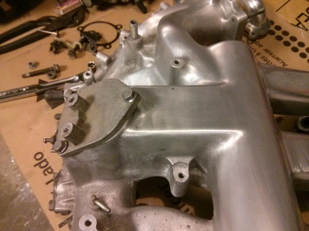

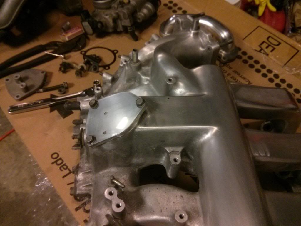

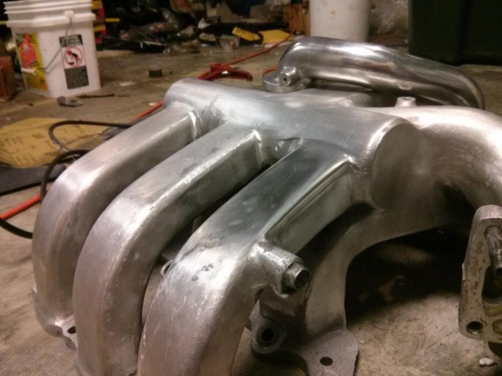

Then wanted to smooth out the top cap:
I think I will keep thinning that plate out , see if I can get a little more clearance out of it.
Also shaved off the nub:
"Clanky" has since this work taken all my free time. It's going to be many weeks before I can start back on this.
